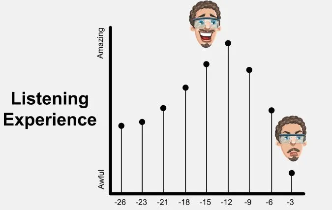

Many of those limitations were removed when CD and hi resolution audio were introduced. However, a funny thing happened... the idea that louder is better became the target. You have a system which can hold 96dB or more of audio range, but the music has been squashed down to use a quarter of that. That led to the loudness wars, and when the various streaming services came into existence, the idea of mastering to optimize for each platform took hold. So now you need a version with -6LUFS for CD, -14 for Spotify, -16 for Apple, -11to15 for Youtube, etc.....
This became the target.
There's no reason that you can't have a CD with a -16 LUFS or even -20LUFS if you have a lot of dynamic range. It won't sound as loud as your typical AC/DC song, but for a singer songwriter track, or a classical piano/violin concerto or a symphony, it can be perfectly appropriate. Gustav Holst's The Planets wasn't written to fit into a -11 LUFS pigeon hole. Yeah, it probably won't be good for background music while you are running the vacuum, or cutting grass since half of the music will be buried in noise. But if you want to sit down and listen to MUSIC, it's perfectly valid.
