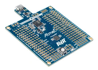

If you don't mind building a box to hold the switches and a credit-card sized PCB, you could probably find an electronics friend to whip up a MIDI output and write some program code. Your requirements are very simple, so the coding should not take much more than one hour.
These boards are about $10, but will need MIDI to be added by your friend.

Thanks for the reply. I have thought the same thing, but don't know where to find a person with those skills. That's sorta why I came to this website - hoping someone would know of someone. I have even bought a Roland board intended for their midi guitar which I figured could be used for the metal board itself, footswitches, and midi connectors. Any idea where i could go to find someone with coding skills?
I could certainly code the firmware, but as you also need the MIDI output circuit it may be better to get the person who provides that hardware to also code the firmware too. Unfortunately, I am in Australia, which makes the hardware difficult due to the time and money wasted on transport if I built it. (Of course, emailing firmware would have been no drama.)
