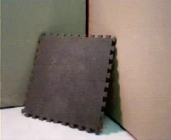

This stuff
I believe this is the stuff C7sus is reffering to.
It is interlocking like a puzzle. I have used these under my studio walls. The walls aren't finished so I can not tell if it worked or not.
They aren't hard at all. But, they do compress quite a bit when objects like music stand are set on them. I have no idea what the real density is. So, if you were to throw a rug over them that might help to spread out the weight.
Hope this helps!
