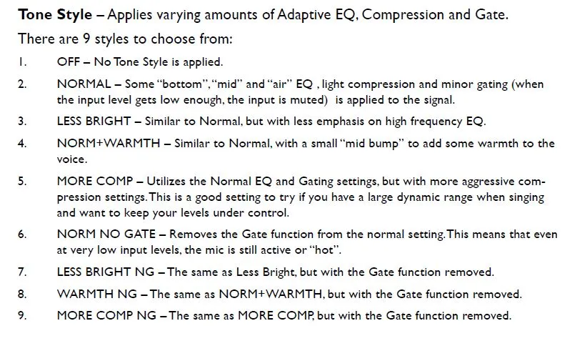

I've got the GTX and the EQ and compression are pretty limited for tweaking (see below), but the 'Adaptive tone' feature does work fairly well make adjustments per what it hears coming into it. The Voicelive Play is about the same box minus an input for an instrument, but does have an 1/8" AUX input that can drive harmonies if wanted. For the VL Play this about the best price I've seen > https://www.bhphotovideo.com/c/product/1027137-REG/tc_helicon_996356005_voicelive_play_pedal.html
