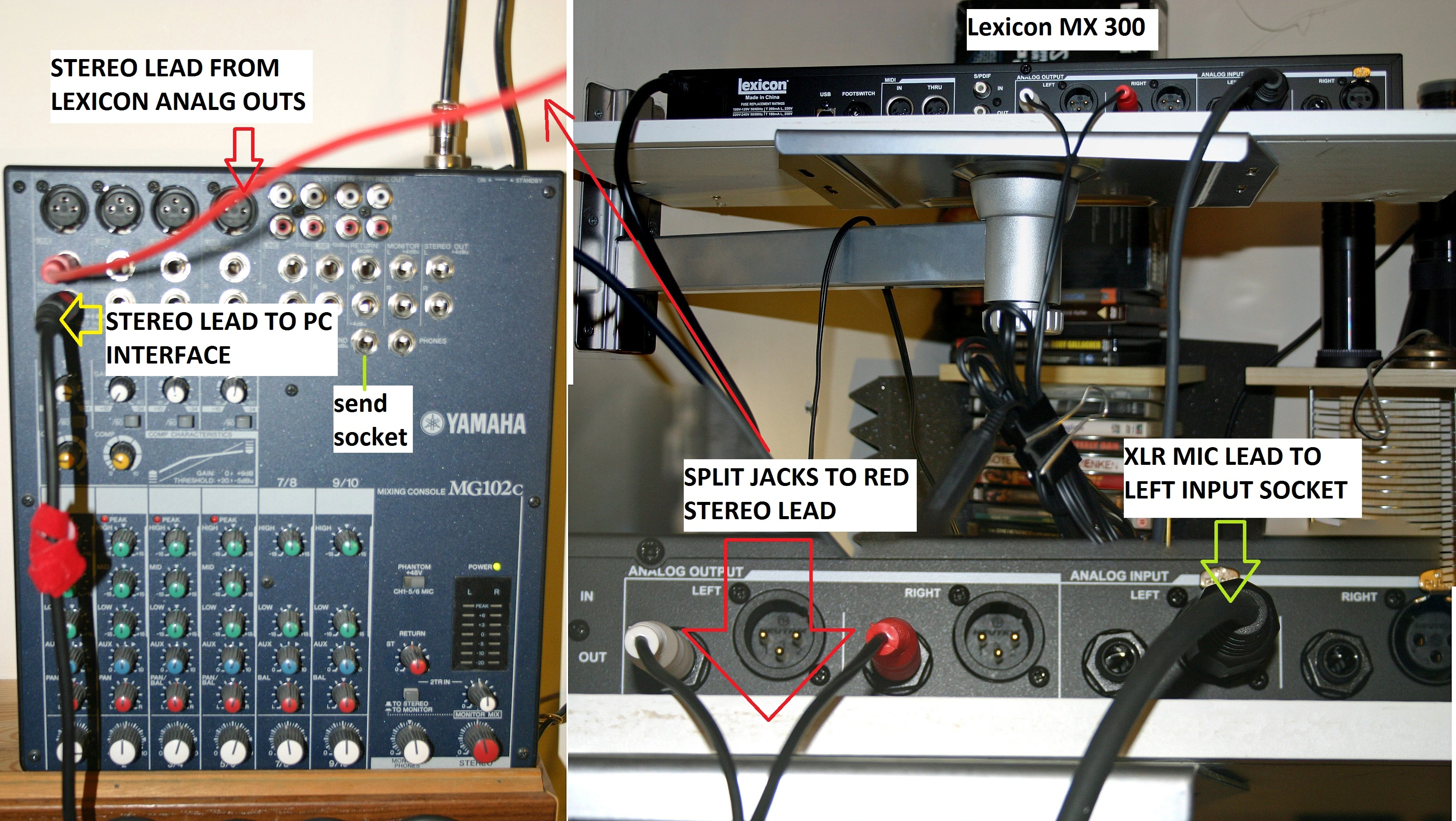

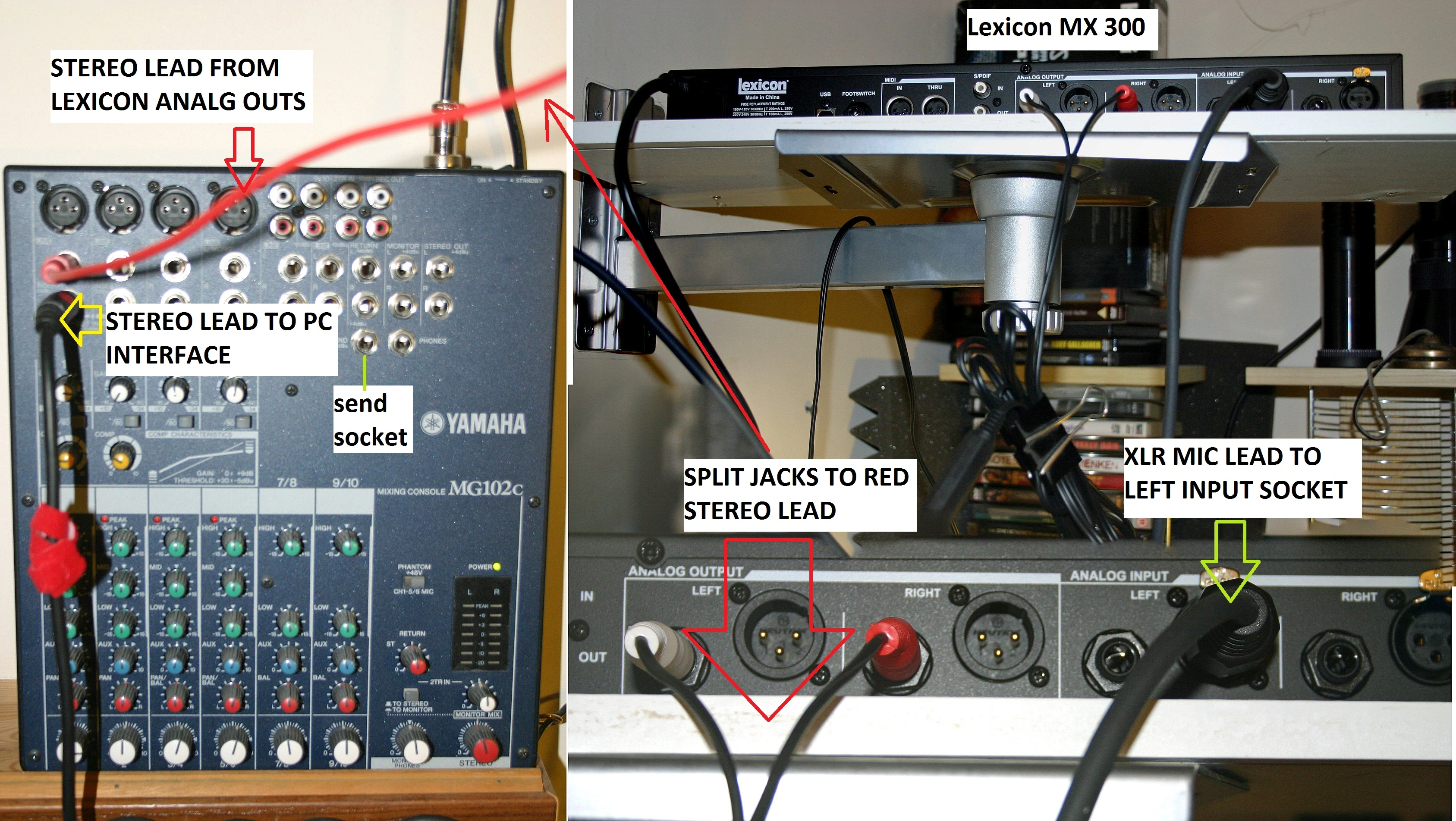

Managed to get the Lexicon set up okay - plugged mic to it then ran an xlr out to the Yamaha mixer, then a 1/4" jack out to my FastTrack DAW interface.
To begin with this seemed to sound okay, then I noticed a faint, high pitch whine in the background - and a lot of hiss. Juggling volume on interface, mixer and Lexicon managed to lose a lot of the background noise, but it did not compare to plugging the xlr dynamic mic straight to the mixer/DAW which is totally interference free [ but no efx :( ]. Am i doing something wrong?
That's not how the Lexicon is meant to be used. Plug the mic into a mic input on the mixer, connect the Lexicon according to the above diagram, use the aux send/return controls on the mixer.
Have set the Lexicon by the manual, selecting mono 'L' in the set-up, and followed the wiring diagram exactly. The whining noise was sorted by inserting a stereo lead between the mixer and the interface, no idea why the stereo lead suddenly became an issue. However, I then found despite hooking up to the analg Lexicon ins & outs I was just microphoning straight through the mixer, the Lexicon was doing nothing, no effects, nup. This is what I loathe about digital equipment, you cannot buy something and use it out of the box. I got the Lexicon to work (without reading the manual) but with background noise - now I have studied the manual, eliminated the background noise - by trial and error - got decent sound - but zero reverb or anything else from the unit. It won't be impossible something got switched off in one of the many menus - off to the tube to do a bit of research :-|
Cripes thanks, I'll try again - that manual it comes with is useless - there is not one diagram for use with a microphone :-o

Had a brainstorm & did something completely different - but it works - no idea why? But good, clean levels in the software.
Don't know why it works - but it does - the trick was to a) plug the mic to the left channel, which I'd configured in the menu, then b) add another stereo lead to the set-up, this time between the Lexicon and the MG102c. It works, I microphoned through all the factory set efx and recorded the test at the same time - excellent sound quality.
The whining noise was caused by the mono jacks, when I replaced them with stereo jacks - perfect sound. Total mystery, I only have one stereo lead because I never use them, I had to cobble the other one together from bits and bobs :-o

diagram
Thanks Mark for the recent post,
Part of my problem is I never used advanced analg mixing equipment back in the day, so I am still wrestling with the 'send' concept.
My 'new' set-up works but it does not give me as cleaner signal as the straight mic, probably for the reasons you outline for inputs/outputs being unbalanced. Can we go by your diagram one more time please, this time with specific reference to the xlr dynamic mic I am using.
I am assuming that all the jacks from your diagram are mono - is this correct?
There is one lead coming from the *send* socket - where does this plug into the Lexicon please?
There are two leads, L+R Returns on mixer, with jacks going into them, presumably both coming from the 1/4" outputs from the Lexicon - is this correct please?
Where precisely does the xlr mic plug in please, if not into the Lexicon then where on the MG102c please?
And finally, how do I run a lead from the mixer to my interface, which socket on the mixer will I use to do this? My speakers / phones come off the interface so I need to have this in the chain or I cannot hear what is going on - or indeed record the results on my pc.
