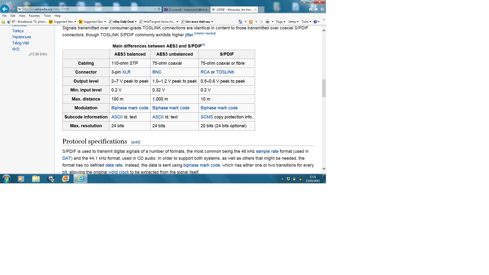

The attached clearly shows that S/PDIF should run a 20 bit stream and at any sample rate up to 48kHz.
Must be some other problem.
