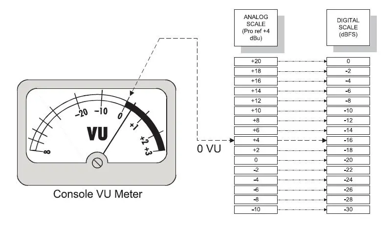

So my final mixes or at RMS -10, PEAK -6dbFS. So the highest audio level in dbFS is -6 for me. Im giving the Mastering Eng as much as 12dB of Headroom. Im allowing him all that dB "ROOM" to polish and build upon. Mastering Eng have some amazing equip. Manley's, API's, CraneSongs, GMLs, Chandlers, Masalec, Wiess, Neve, Prisim, & Fairchilds. And also some of the top converters in music PERIOD and you would only give him 1 dB to work with or worse 0.01?
 Dont know bout yall but I want to give him all the dB I can give. I want MORE of my sound to be able to go thru all those goodies not less. Thas just my take on it and how I perceive it...Could be wrong.
