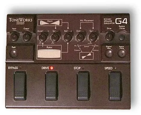

Having owned a couple of Leslie's over the years, nothing really completely emulates the sound. However, I do currently use a Korg G4 Rotary Speaker Simulator. It's by far the best I've heard...and it weighs about 4 pounds.:D

It's just my opinion, but I think digital simulations of rotary speakers are the weakest emulations arounds.
There is nothing quite like physical moving air around in circles. I had the Korg unit and tried many other simulators, but was never satisfied until I got a Motion Sound rotating speaker. Mine is a beat up piece of shit, but it works and sounds way way way better than the well intentioned simulations. Plus, I got it for $150
Of course, YMMV
Of course, YMMV
True dat. Nothing replicates the spinner. The OP was looking for pedals, tho.:cool:
