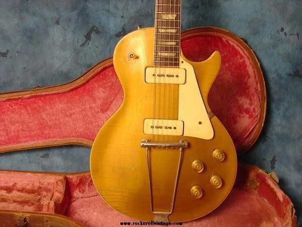

I was thinking about the same thing, but you've worked with setting them up and first hand experience with the tailpieces and you stated it all very well. I found a picture of the early gold top's trapeze tailpiece with the strings wrapped around.

Actually, the way it was designed was for the strings to come off the top of the tailpiece in a wraparound fashion because the tailpiece was also the bridge. The tune-o-matic design where the tailpiece is just to hold the strings came later.
The tailpiece, studs and anchor are all more than robust enough to withstand the forces you are concerned about. Remember, the tailpiece was designed before light gauge strings were available.
The photo in the earlier post is of a '52 or '53 instrument. See if you can find a picture of a '54 or '55 that hasn't been modified. The tailpiece looks just like a modern one but there is no separate bridge.
You'll see the same configuration used on many Les Paul Jrs. except there is compensation cast into the tailpiece.
