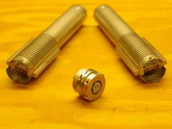

In pic #1, one of the caps is off--they just pop off after you remove the two little screws at the top. You can see where I drilled holes in the caps. That's the nut and bolt I use to hold 'em together. Had to saw the bolt down to just the right size to fit it all together.

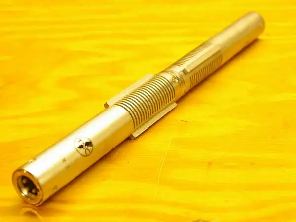

In pic #2, you can see how the two caps are screwed together, at a 90 degree angle from one another. You can also see how the bolt doesn't protrude beyond the recess in the cap.

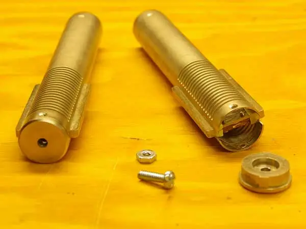

In pic #3, the caps are back on. Yeah, it's long and a bit goofy looking, and it has a mic cable coming out of each end, but it's great for exact placement.
After I thought I'd invented something cool--I looked on the ol' interwebs and found companies selling the exact same thing. They just mounted the guts from one on top of another and had it pre-wired with a "double" XLR cable coming out of one end. Prettier than mine--but mine was cheaper!
Oh--and for the record, I didn't use this rig on the recording. I had taken them apart because I was micing two different amps with 'em. I just put it back together for these pics.
