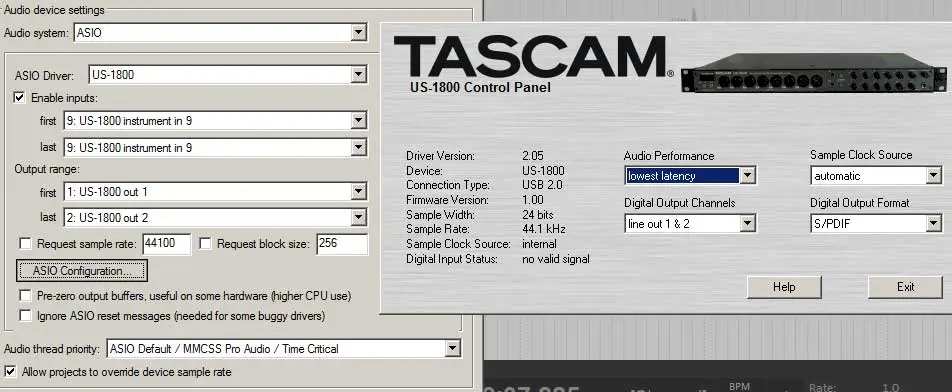

12ms does sound like a lot. 49 samples at 44.1K sample rate is 1.1ms. Double that for input and output and you should still only be at 2.2. You've installed the ASIO driver, and set it to lowest latency in its control panel, but have you specified in your DAW to use that driver and are you sure the DAW is not somehow overriding or "requesting" some other buffer size.
Reaper is set to use the interface's ASIO driver and to not request a buffer size. I've attached a screenshot.
