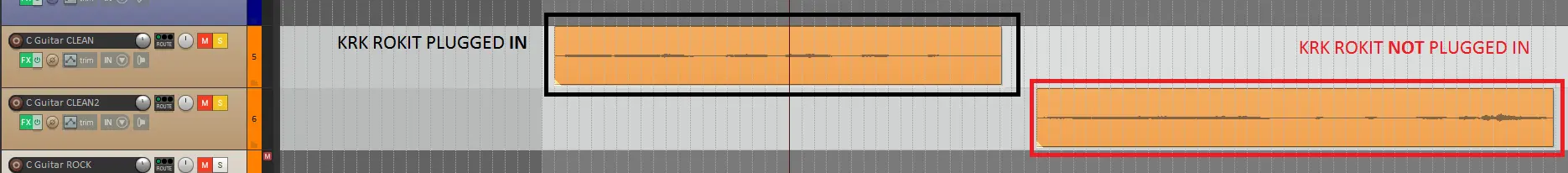

My name is Jeffrey and am, like many others here, spending my time doing some homerecording. (In my case just as a hobby!)
Lately I've been experiencing some "strange hiss" on my recordings.
Some investigating (as in removing different cables from my powerstrip, plugging it somewhere else etc.) has led me to believe my 2 KRK Rokit 5 Monitors are causing the problem.
To illustrate:
You can listen to it here at this link:
https://soundcloud.com/jeffrey-beutels/hiss-clean-comparison/s-vV7OD
The second 'Red' (hiss-free) part starts at around 0:40.
It seems the annoying hiss is gone when I unplug both of the KRK's and just use my headphones to listen.
I'm using a Focusrite Scarlett 6i6 and am using the Reaper DAW. Guitar used is a '99 Gibson Les Paul Standard.
Any input or feedback would be greatly appreciated.

The noise increases with your guitar volume. Have you tried plugging the KRKs into a different power source (run an extension cord into another room)? It's got to be a ground loop issue.

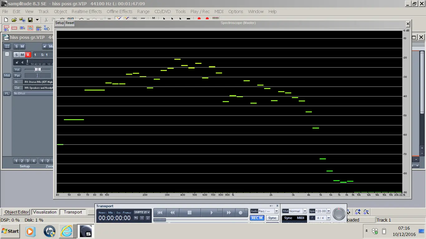

I don't know if it is a by-product of the mp3 encoding but there is very little of anything in that clip past 3kHz and just about buggerall past 5kHz.
I know I am well mutton but I can usually hear loud stuff on cans out to 5kHz or so but I cannot hear any hiss on that recording. (why can't we attach short, 20sec .wav clips PLEASE?)
I tried a different power source for the 2 KRKs but it was in an outlet of the same room, I assume it still in the same loop then?
All equipment is on the same powerstrip.
