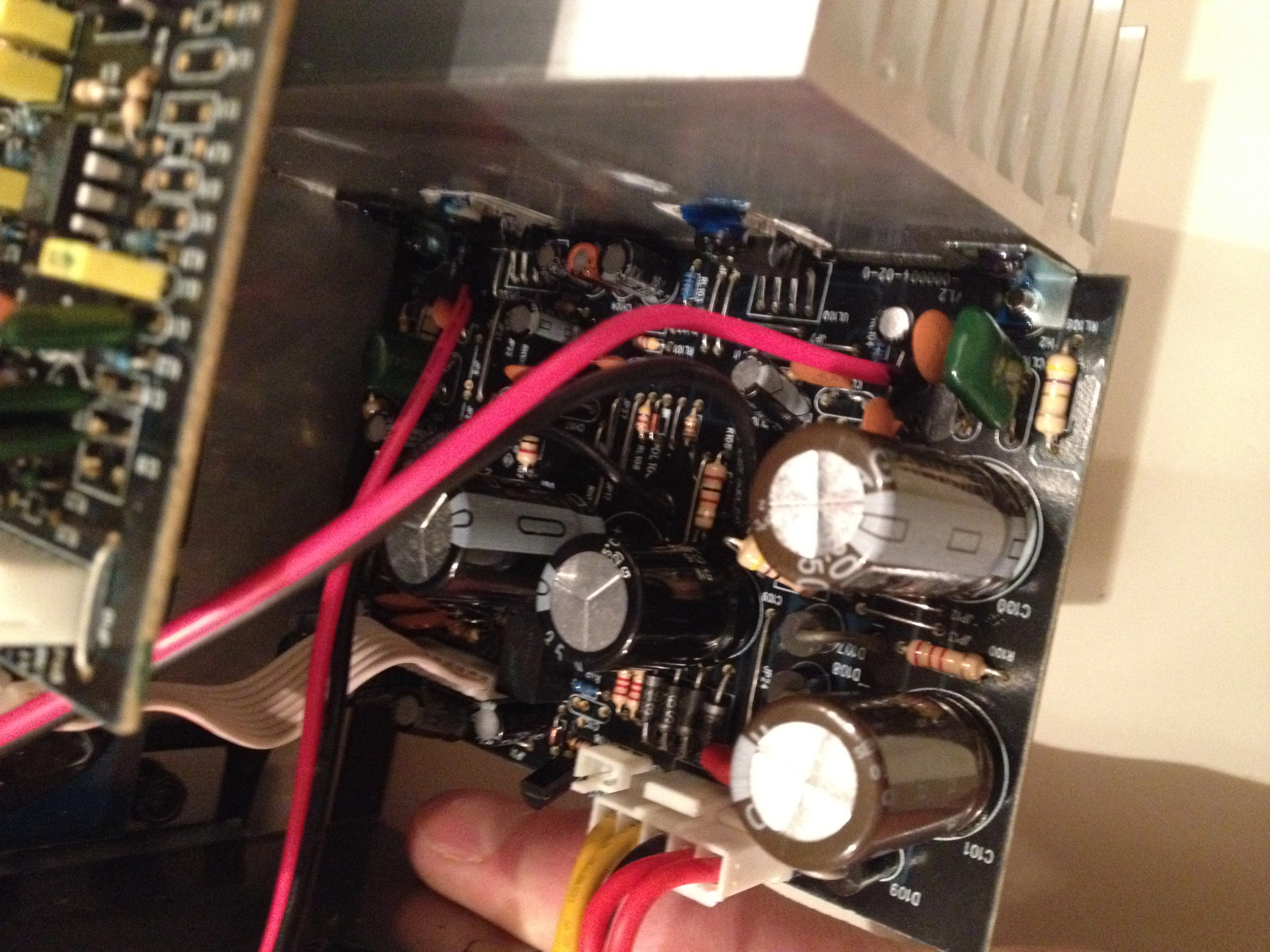

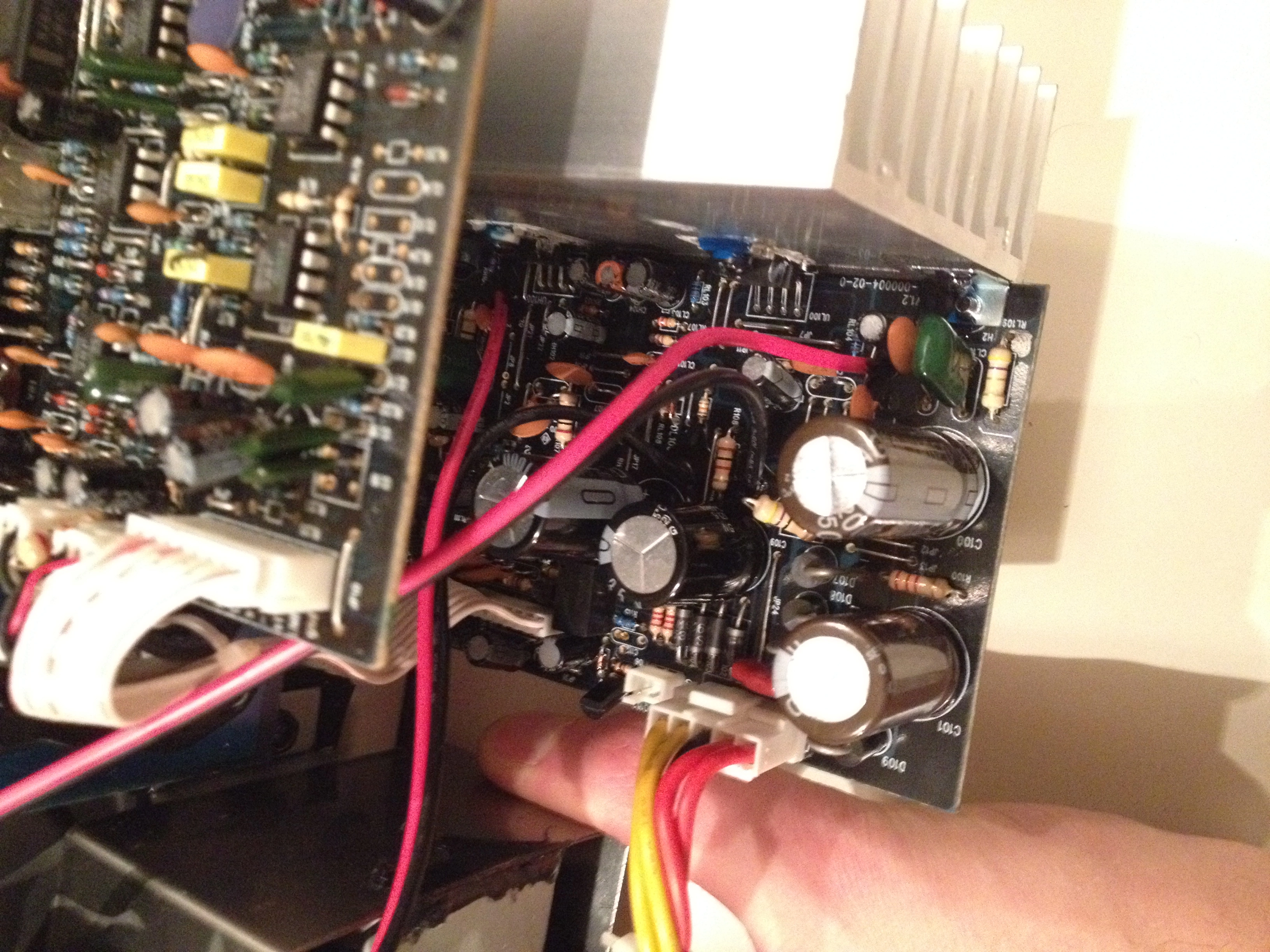

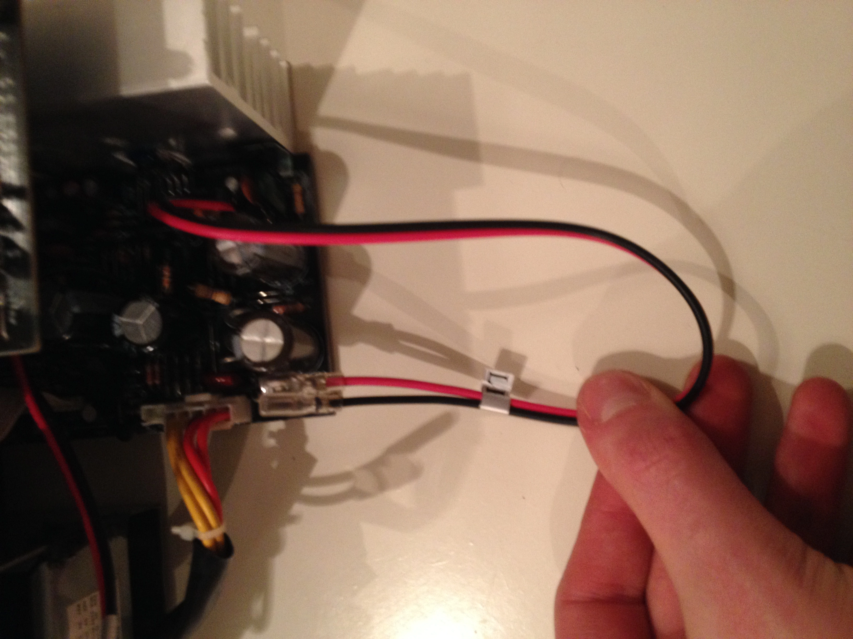

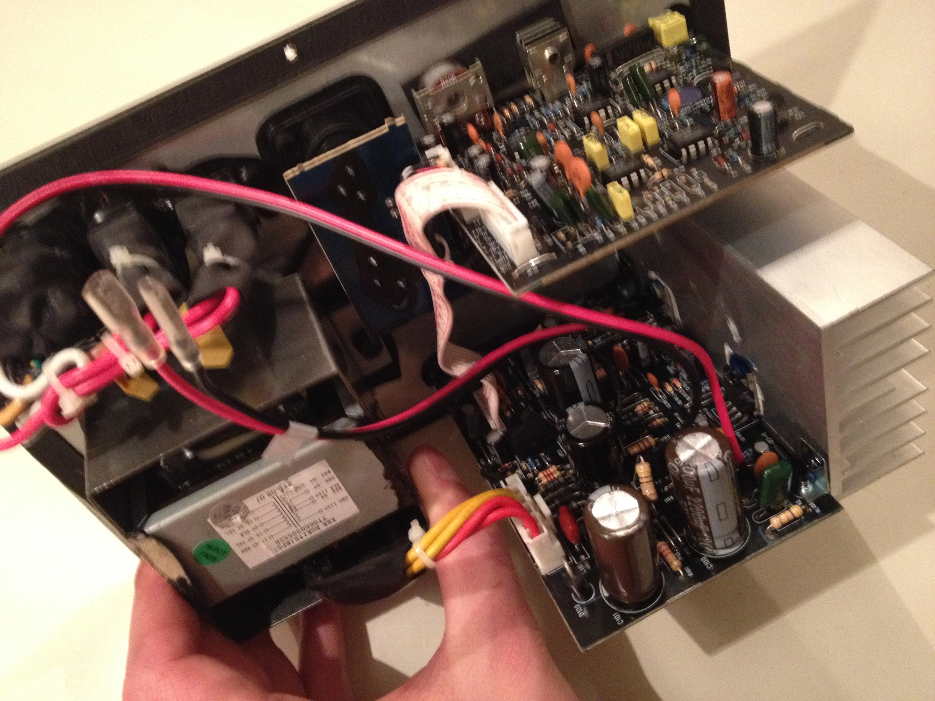

Since yesterday I have a problem with one of my KRK speakers.

The problem is when I put the speakers (LV see picture) on that DC (started by 22v to 7v) comes to the woofer..
