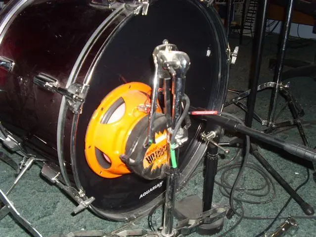

You could make a subkick. That'll get ya the oomph.

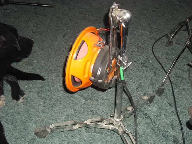

I made one out of a cheap Radio Shack sub, an inline pad and an old snare stand I wasn't using.
I'll see if I've got pics if you're interested.

I just looked and have the pics on my pooter at home so I can send em tonite.

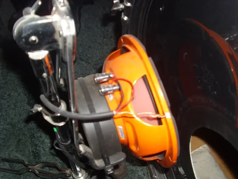

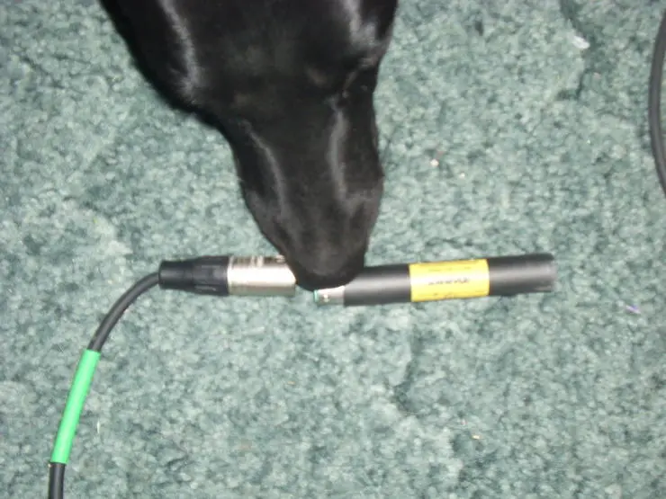

I paid about $30 for the speaker, $20 for the inline pad switch, and chopped the end off one XLR cable. (make sure you chop the right end...unlike some boob I know :rolleyes:)
Wire the pos on the XLR cable to the neg on the speaker. Vice versa for the others and then for the shield wire (probably copper uninsulated), I just took a file to the speaker chassis til I got nice clean metal and twisted the wire down tight. It could look more pro but I'm all about function. ;)
The key, I think, is the inline pad. The signal coming from the sub is really hot. I tried just kickin a pad from my pre but it's gotta be padded before it hits the pre.
I track with it all the time but it doesn't always get used.
I'll grab da pics tonite. Pretty easy stuff except for figuring out mounting and I found that old snare stand works great.

My pics suck but ya get the gist.
The reeeally blurry one is a Shure a15as but have seen other pads that are cheaper.

Nice Dogbreath! I'm going to build two... I'm thinking about building a smaller one to mic up the rear of an Orange git amp as well... see if I can capture some low end out of the amp.

Hey Dog, not to sound dumb but what is a pad? I don't know that term. I think I found a good speaker for my sub kick. I have an old 150 watt sub with duel 6 1/2' Yamaha's I Think that would be good for this. Thanks.
