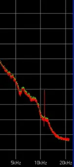

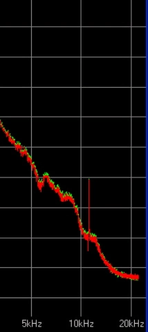

A quick response - Terry's going to have a go at rerecording the vox. The ones on the track are cleaned up but there's still a very narrow peak at around 11khz that I can't treat effectively. See the attached snap for a view - it's MUCH better now than it was - there were a couple of peaks & they were HUGE!
There's a prob with Terry's signal chain - he's addressing that before redoingthe vox.
