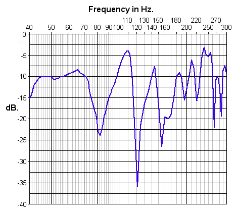

Az:
> I have the numbers of all the frequencies in between. Most of the times, they only vary 1 to 2db from the intervals. So I excluded them from the chart for simplicity. <
That's surprising. Is your room very large? Most small rooms look more like the graph linked below.
--Ethan
--Ethan
http://www.realtraps.com/art_response.gif

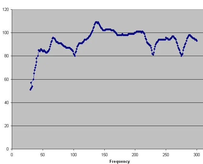

Um...no..it's about 10'x10' and about 8' high. Maybe the fact that I put my monitor so near the ball (to enhance bass) makes it different from your graph.
I have attached my graph with every point plotted out.

Az,
> I have attached my graph with every point plotted out. <
I see now that missed something very important the first time I saw your low frequency graph: I missed that each vertical division is 20 dB! I'm still not sure why you don't have more peaks and nulls. But it could be as you suggest, due to the speaker and/or microphone placement. Either way, clearly you will benefit from bass traps! :D
--Ethan
