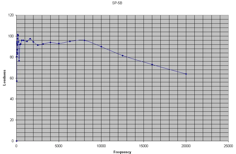

Um...I did some reading before posting this. Granted, many posts have discussed the topic of using an SPL meter to measure the frequency response of room/monitors. However, I learned that those threads are very conflicting and confusing, often sidetrack, or offer solutions that I cannot afford to take.
I have plotted a frequency response graph of my monitors the SP-5B in my room. I am hoping that you guys can provide some quick fix to improve the response as much as possible without making me spend any more money.
Bass traps? - No thanks. Those cost money and a load of more headaches.
Move the monitors? - Sure. Um...how? where? Do I have to go through the entire test tone CD and graph the whole spectrum again after every little nudge I make to the monitors (that will waste a lot of time since plotting the whole spectrum took me an hour)?

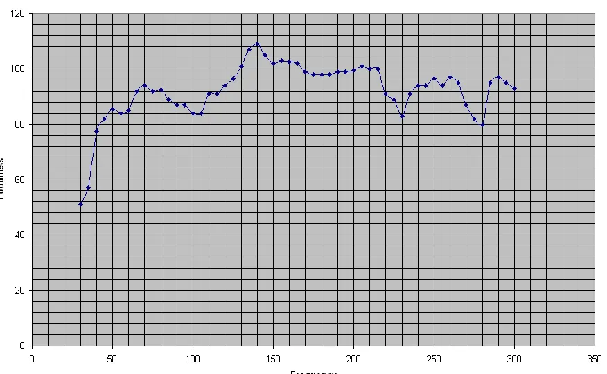

Here's what I did to analyze my monitors. I downloaded a test tone CD. I put the SPL meter on a tripod at my ears' position right inside the equilateral triangle. Then, I played the pink noise and adjusted the volume on the monitors so that the SPL meter displays 82dB. {Some people used the tone 1Khz as the reference at 85dB. I didn't do this. Does it matter?} At that volume setting, I began to play each test tone and write down the SPL meter's reading at that frequency. Whoo! That was very tedious, especially with the bass test tones.
I am attaching my graphs. Please tell me what can I do with it?

1. Throw those charts out. Seriously.
2. Learn the characteristics of your monitors by ear. There are two ways to attack this, both of which you should use. First, take your favorite commercial CDs that you know how they sound in your sleep and listen to them on your monitors. I mean listen. Listen to the monitors themselves and how they color the music compared to your memory and compared to other real-world systems. Second, make a few mixes on the monitors until they sound right. Then take those mixes to other systems and see how they translate. These techniques will help you determine how to plan for that translation in your mixes.

I can understand your desire for visual aid. The problem here is that unless you are using properly calibrated equipment to measure the response, the measuring equipment itself will be coloring the results. Simply put, they cannot be completly trusted to be telling you the truth.
I know it's tough to train one's ears satisfactorily and it takes some time and effort, but the benefits of doing so are immesurable. Your ears are the most important link in the signal chain. Until you have them reasonably well "trained", they will add their own heavy and unpredictable color to your mixes, no matter how good your equipment, acoustics and techniqes are.

yeah I dont really trust those SPL meters to be very accurate but these charts make sense. There are similar peaks and valleys pretty close to an octave apart. Plus, 30 db swings in the bass end, I dont think the margin of error on the meters is THAT large, so something HAS to be going on there. There must be some truth in these charts.
That said, yes, try your speakers in different positions and re-chart. If you could get those swings cut down to 15 or 10 db you would be in much better shape. have fun! I might try this myself!
You at least need a calibrated meter, which means you need to know its response across the audible frequency range. I use a reference mic instead.
What I can see in your charts is that you probably have some nodes in your bass. That cannot be fixed by adjusting your mix. Whether you want to admit it or not, create a proper acoustic environment is critical for good monitoring (tracking too). Anything else is a compromise. Get some bass traps.
Your high end response looks normal for pink noise--if that is what your test tone CD was trying to approximate. If, however, each frequency on the CD was the same SPL, then you are looking at the performance of your tweeters, which doesn't look particularly good--good tweeters shouldn't rolloff until at least 12 kHz.
Once again, it could be the sensitivity of your SPL meter at those frequencies too.

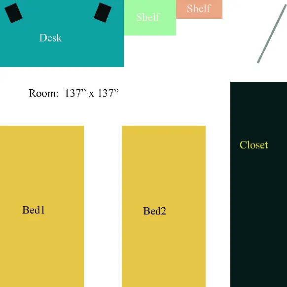

Well, I put my monitors really close to the wall to enhance bass response...as I have read that the bass on these SP-5B's are weak.
What do people mean by re-positioning the monitors?
-Do they mean...face the monitors a different way (but I thought their faces are suppose to point at my face!)
-Do they mean widening/shortening the sides of the equilateral triangle (I space my monitors apart at 40")?
-Or do they mean move the computer's desk and the monitors to a different area of the room? (uhh...where's the best place in the room to move them? So, if that doesn't improve...I would have to move them somewhere else again? Man...unhooking all the cables and moving the desk would take so much time alone as it is.)
Right now I have my computer desk in a corner of the room. It's not a corner desk either. It's a rectangular desk...so I have my left monitor in the corner...and the right monitor ...not in the corner. The monitors and I form an equilateral triangle with sides of 40".
I have attached a drawing of my room. All the objects are very proportionate and in exact ratios relative to the room and to each other.
Get the left speaker out of that corner. Swap the desk and the green shelf, maybe.

> I have plotted a frequency response graph of my monitors <
I agree with the advice to throw out those graphs because they're meaningless. Your low frequency response is much worse than what's shown, and you need to measure at 1 Hz resolution to see the true response. Your LF graph appears to be at 5 Hz intervals, and that's just not enough.

Second, what I am suggesting is don't try to fix a node in the mix. Bad idea. Your suggestion is to learn the monitors & room. Sure, that works, although it takes more time upfront, and as you go along since you'll spend more time listening on different systems to check.
Having seen the room layout afterwards, I don't think it's so bad. Beds make pretty good bass traps :) and the big obvious flaw is the monitor in the corner. Fix that--for free!--and I bet those graphs look much nicer :)

At the very least ... get the damn speakers out of corner.
Jeezus. Talk about a recipe for disaster. No wonder.
Secondly, get them away from the wall a little, if you can. You've got, what, two bed mattresses there? That should help out at least a little. If you could move a heavy couch or something in there, that would certainly help.
But Jeezus, dude. You're mixing in the corner. Get the heck outta' there. Then we'll talk about bass traps and room treatment or whatever.
