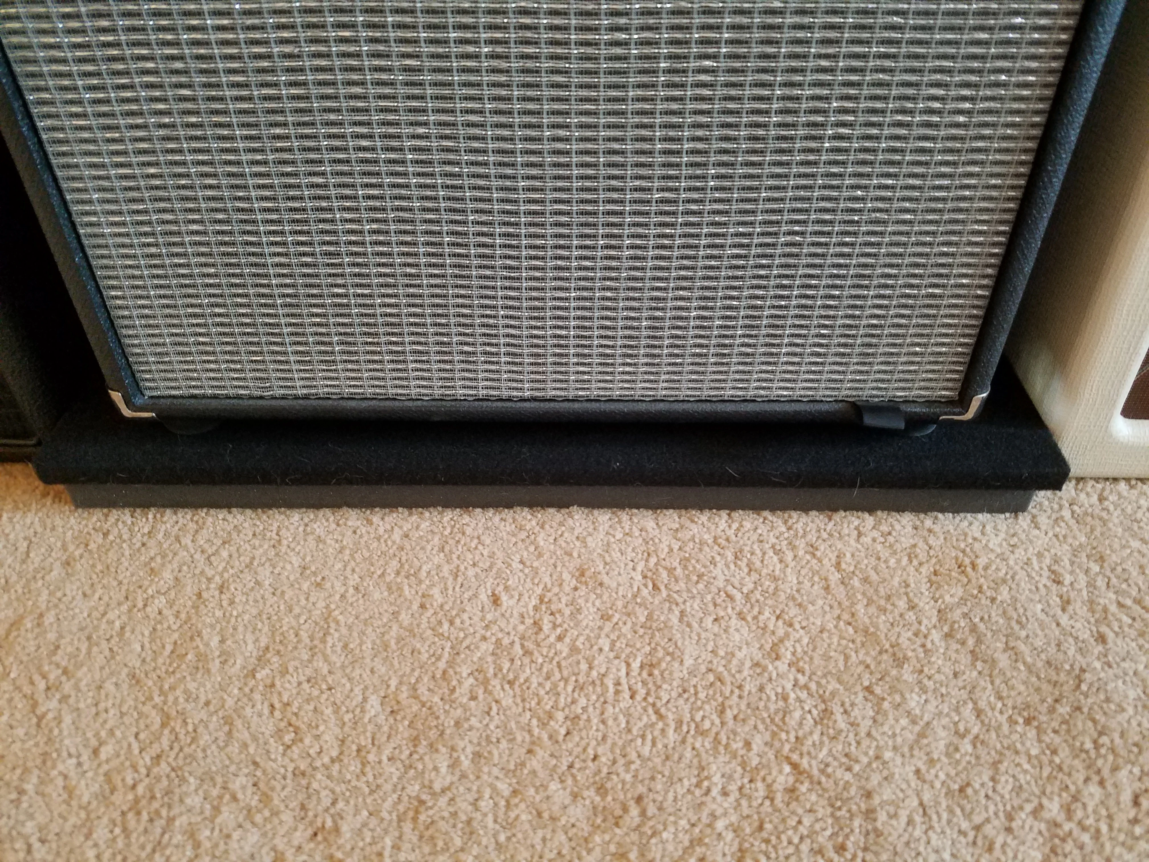

Don't forget acoustic isolation for your amps, especially your bass amp. I put an Auralex GRAMMA v2 under my Fender Rumble 200 combo. My studio is in a bedroom-sized loft on the top floor (I have 4 half-floors built into a hill). There's an open stairwell all the way down. Decoupling my bass amp with the mid-size GRAMMA cleaned up the low end noticeably.
Auralex Acoustics | Total Sound Control
My little Vox and Ampeg practice combos are still on the floor.
