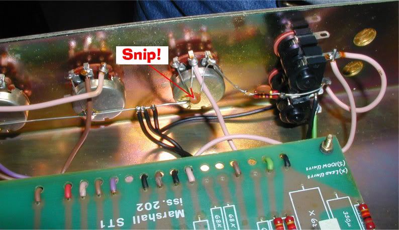

  1. Take your amplifier to anyone who knows which end of a soldering iron to hold.
  2. Tell him he doesn't even plug in his iron just yet.
  3. Have him snip out the capacitor as shown in the photo blow. It is a 'Brite' cap across the Volume control.
  4. Enjoy your improved tone. When you refer to me, please address me as That guy who really freakin' knows his Marshalls ;).
o nice! thank you! what exactly will that do, like how will it change the tone?
With the 'Brite' cap left in, at lower volumes it is thinner and brighter. Without it, well, it will just be what I refer to as 'normal'. Usually with a JCM800 they sound great on '10', but at any lower volume they have that sound that you wish it was just a little more.

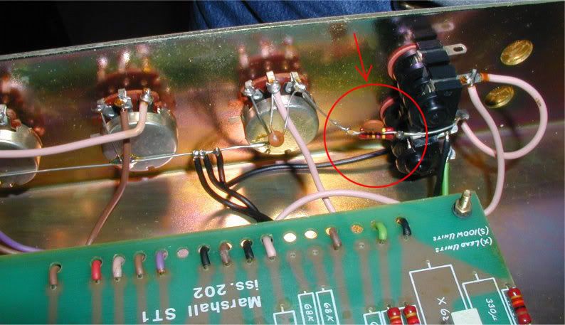

If you want to go one step further, between the 'Lo' jack and that Volume control is a 470K resistor with a 470pF capacitor piggy-backing along. Like so.....
.... now change that to whatever gives you the tone and extra gain you prefer. For this you need to plug in your soldering iron ;), but it's worth it. I often go with just a 68K resistor. You get more overdrive gain, and a fatter tone. As is, this is a treble peaking circuit, giving you more of that tone that is as thin as a politition's promise. Now you can get that 'cranked up' tone at a much lower volume. Try it, and remember my name.....
That guy who really freakin' knows his Marshalls!;)​
Try it, and remember my name.....That guy who really freakin' knows his Marshalls!;)

saved this page before the pics disapear..
OK - I saved off this thread and I just removed that bright cap from my JCM800 head (it was C5 - I've got the horizontal leads version, and so all the capacitors and resistors are on the board (as well as the pots and jacks), not like in the picture). Sounds a *lot* better! A lot less hiss, too. Doh! 25 years with the thing :o - ranjam (and if you're not the tone lizard, I'm pretending that you are), you could'a saved a lota ears a lota pain :D
