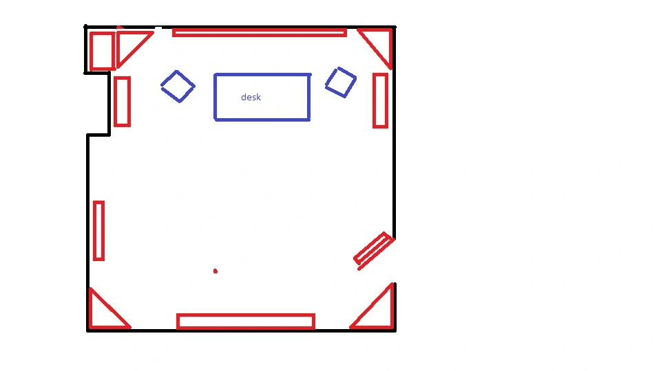

the room is treated as much as i can but the room is really not ideal in shape 10x10 pitched ceiling to a big beam going to the back section height of about 3 metres. a chimney breast down one side (major base collecting point) .
i have 4 super chunk base traps in the corners (rs100) floor to ceiling at rear of the room and as tall as i could get them at the pitched side. as much insulation in the small resess at the side of the chimney.then the base trap
hard to explain heres a quick drawing.
this takes care of alot of the problems but i was hoping the jbl would sort out the rest

Same thing applies though -- If you have a 30dB null @ 100Hz by your left ear, the thing isn't going to boost 100Hz by 30dB out of the left speaker to compensate (the speaker would liberate itself immediately I'm sure) and if you have a peak of 10dB at the other ear the only thing it can do is cut 100Hz almost completely.
That's not accuracy.
At risk of sounding like a harbinger of bad news, you're in an acoustical nightmare. Not just a "gee, this isn't such a hot room" but more or a "there's barely anything you can do to make that room acoustically viable" nightmare.
The only things you can really do are to A) trap the hell out of it and B) try to learn it. I was stuck in a room not far off from that size for a couple years some years back. Giant peaks at one point in space, huge nulls and voids less than a foot away - Always having to remember to move (only slightly, mind you) to certain positions to listen for certain things... It was horrible. Corners, bass traps on the front wall, bass traps on the rear wall, light absorption on the side walls - Sure, it helped - but it was still a tough room. But the last thing you'd want to do is make the speakers as inaccurate as the room... Those "speaker fixer" things are reasonably good at fooling a room into a more enjoyable listening experience - but certainly not a more accurate listening (and tracking, and mixing) experience.

The amount of bass trapping to tame a 10'x10' room is going to be extreme - very extreme. Corners aren't going to cut it - It's a start - but just a start.
well what the f*** am i gonna do then lol :(
aside from corners and tri corners I was thinking of putting broadband bass traps at first reflection points and overhead... also I was kinda thinkin of a gobo/standing broadband trap that I could setup horizontally a few feet behind mix position to kind of take the back of the room out of the equation.
Any suggestions? (If need be I can post pics of my situation)

just add a chimney breast a bit firther bown than the side window (remove the window) and slide the door down to leave a corner a bit bigger than a 600mm wide base trap.
should i have used 200 kg/cubic meter for the base traps i could add some more to the front of the superchunk triangles , the back wall behind the mixing position has a 1.8m high by 1.2 meter long by 4 inches thick trap.
and there are 2 cloud traps on the tallest part of the room.
where else could i trap or is that as much as i can do and just learn the room ?
i could add some pictures if needed
