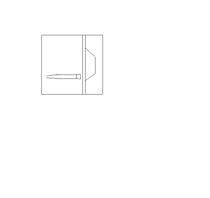

Oh-- to clarify, i am not putting the amp in the box, only the speaker. Speaker is mounted in a piece of plywood.
Attached is a quick mock up from Paint.
Daav

Right, that's what I thought.
I think your box is too small, particularly if it's even close to scale - particularly the portion containing the speaker basket.

ok is that pic showing exactly where you position the mic, when it is why don't you do center speaker and the recorded tone should improve tremendoulsly.

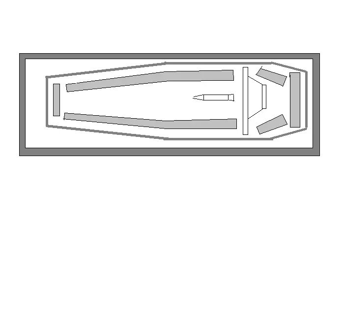

See my design idea below, what do you think? It is box-within-a-box, which is the only way i could really get the volume undercontrol on the first attempt. The outer dark grey recatanlge is the outside box, and the inner cofin shaped dark grey is the inner box. The light grey rectangles will be OC 703 2- 4 inches thick, 2-4 inches away from the inner walls for absorbtion.
The doors will be from the front side in both boxes so I can put stuff on top and still get at the mics and speakers to switch out and change location.
Would love some feedback and input on the proper dimensions of the box. I would use high quality voidless plywood, probably glued and caulked with bisquit joints. The inner box will be sitting on something to try to isolate from the outer box a bit, either the tops of nails or some sort of foam like the commercial speaker isolation things. I may pack moving blankets or some4hting else between the boxes as well.

For the proper size of the part that corresponds to a speaker cab, find a closed-back 4X12 cab, measure it, and divide by 4. You don't need any insulation in that part of the cab. Just make it strong, thick, and tight. Use some foam tape on the baffle where you mount the speaker to eliminate the possibility of rattles.
The "mic" side should probably be as large as your situation can comfortably accommodate. I'd recommend playing with insulation placement on this side - you may just want to have some on a couple of walls, or just in the corners, or you may find some equally cool and unique sounds based on your insulation placement.

Sounds good, so if i read you right, the part behind the speaker should be a bit longer and in proportion ot a 1/4 sized 4 X 12 cab, like if we made a 4X 4 grid with a speak in each section of the grid?
I think I will need to seal the area from the speaker to that back cab part better as well, the one i have now has about a 2 inch gap from a bit above the top of the speaker to the top of the box.
Yep!
For sure, seal it tight. Silicone window caulk in the joints works well and it's cheap. You want to isolate what's happening inside that part of the box from the mic.
