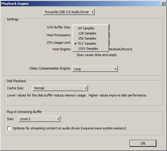

I mean the samples size you pick at the Playback Engine, when you are just about to bounce and everything is already recorded.
http://www.sweetwater.com/sweetcare/media/2013/08/Scarlett_PT_buffer.jpg
That buffer size has no impact on quality at all.
It relates to latency which is completely unimportant unless you're trying to record new parts.
Simply, a large buffer size means the computer plays your mix back a second, or fraction of a second, later than real time.
That amount of time is wiggle room for the computer to read ahead, and means you're less likely to have hiccups or crashes during playback.
Where computer resources are a factor, people generally record with small buffer/low latency, and mix with high buffer/high latency.
