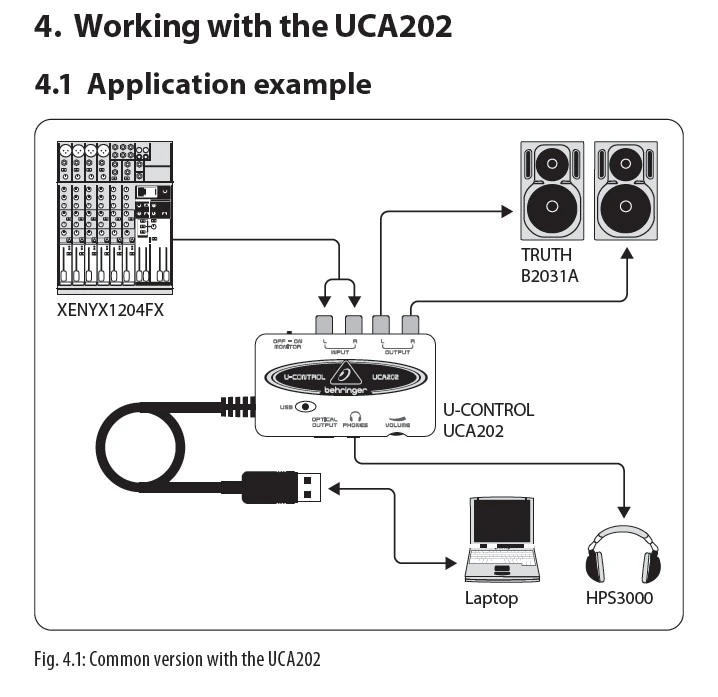

- Do you have it hooked up like the diagram below or do you have the OUTPUT of the UCA202 going back into the mixer? If going back to the mixer, you likely will be mixing vocal and beats on the second pass.
- Are you're headphones plugged into the UCA202 or the mixer. Should be in the UCA-202 to work with the diagram hookup.
- Do the beats and vocals have their own separate tracks. Are you creating a new track for the vocal and not somehow overdubbing in the same track?

Yes I have the output of the uca202 going to the input aux of the mixer. The aux output on the mixer is going to the input of the uca202. Headphones are in the mixer yes. I will fix that. The beats are pre-made as I purchase them so they are on their own track. When I record it rerecords a lesser quality version of the beat with my vocals and I think that is what you meant. I am leaning more and more to pick up an interface as recommended. However is it possible to still make use of the mixer with the interface?
Yes, you need to remove the UCA202 outputs to the aux in on the mixer. Take the UCA202 output to a headphone amp or monitor speakers. The mixer does not have the option to put that aux in to the headphones only (along with your mic input). That's what an audio interface WOULD be able to do.
