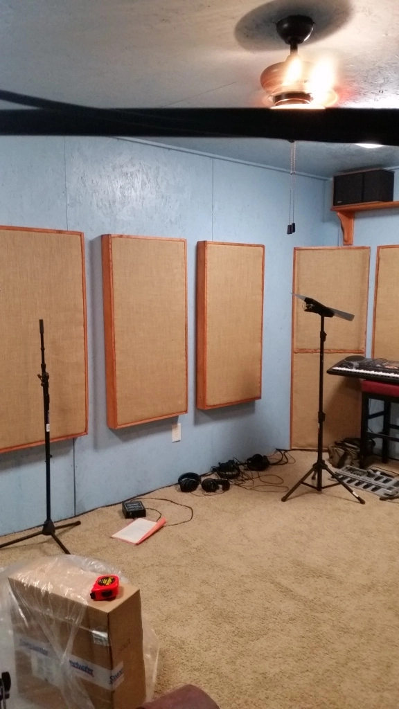

The frames are pretty easy to make, here is a photo of mine, I ripped a piece of 1x4 to make a hanger for them, I can just lift them off the wall if needed.
