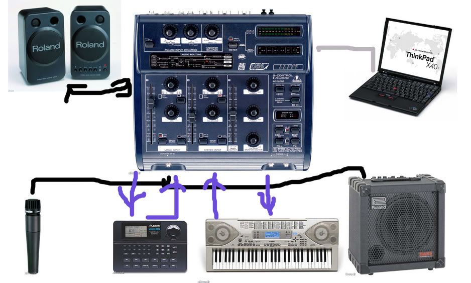

See, this is what Im trying to do:
https://i11.photobucket.com/albums/a160/Neotriz/My gear/Untitled-1.jpg
Im trying to work on a Solo Project so this Audio/MIDI interface is perfect for me.
However, I'm still having hard time understanding MIDI. I know what is MIDI, but what I'm stil confused it how connecting among each other.
I need the Synth to do some crazy effects and I need the drum machine to make some drum patterns. So how would I able be to hook the drum machine and the synth? Or simply I just can't?
My Synth is an old Casio and only consist a MIDI I/O (MIDI thru does'nt consist)
Here are what the pic contains:
-Behringer BCA200 (Audio/MIDI Interface)
-Sm57 (Mic'in the Guitar amp)
-Roland Micro Bass (Bass-->Direct)
-X40 IBM Laptop (Still not sure what program I would have to use; probably I'll go with a SONAR)
-Roland MA8 Powered Monitors
So what should I do?
midi out of the computer -> into the keyboard -> out of the keyboard -> into drum machine -> out of drum machine -> into computer. The keyboard and the drum machine need to be on different channels so you can address them individually.
Here are links to two good articles on midi basics - part one and part two.
And follow Farview's simple road map and you'll be set...
