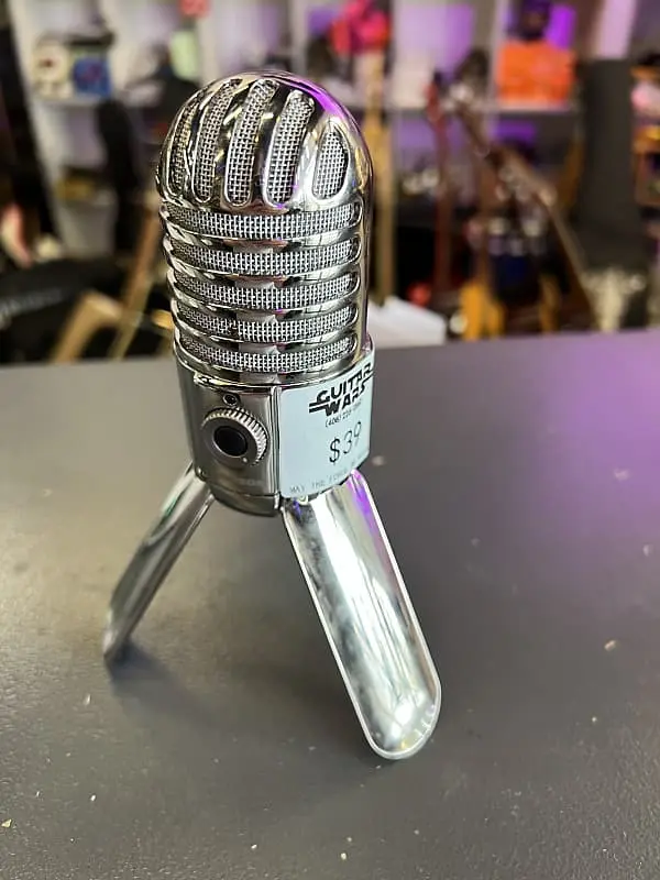

how about one of these? it looks like it has flight capability or something...
