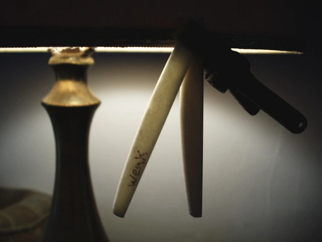

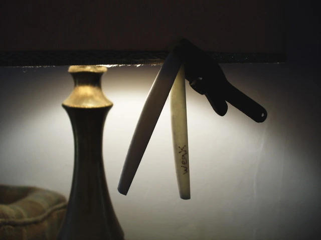

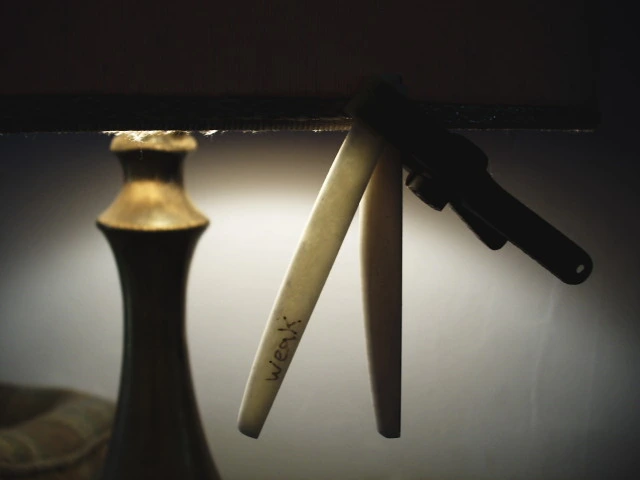

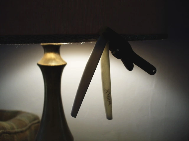

Here are the pictures. I reversed the 2 saddles so no one can say it is a shadow.

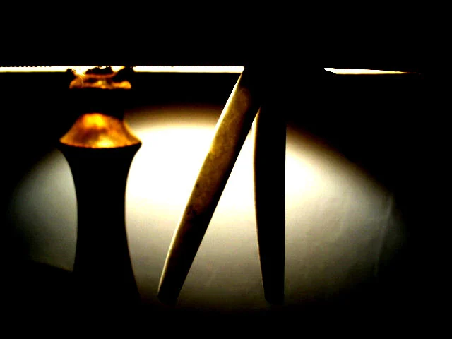

Here it is with increased contrast.
