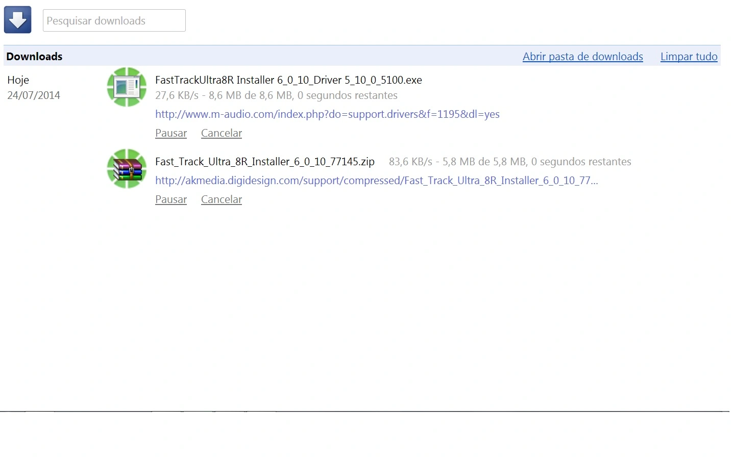

This morning, I removed the new Avid driver and re-installed the last release of the m-Audio driver and everything is working fine again. I believe these drivers are as follows:
Fast Track Ultra: 6.0.8.77158
Fast Track Ultra 8R: 6.0.10.77145
Let me know if you can't find these and I'll post them on my website for download (I only have Windows 7 64-bit versions).
