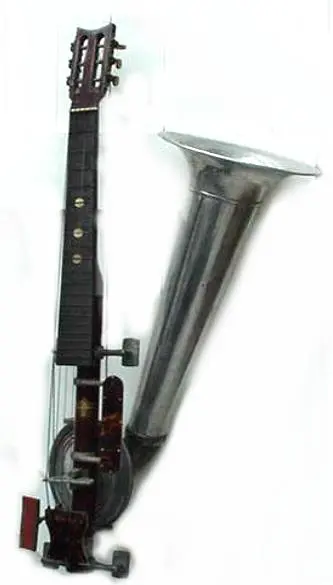

I'm thinking of making one of these over the holidays....
  • Thread starter Thread starter 32-20-Blues
3
32-20-Blues
Its a Stroh Guitar:
It works like a phonograph. A thin rod transmits vibrations from the bridge to the centre of a thin mica or aluminium membrane, which is then amplified by the horn.
I'm thinking of turning the 'reproducer' (the thin metal disc that holds the membrane) out of walnut, and fashioning the horn from sheet copper.

I'd be delighted to. I'm not sure whether to use the traditional membrane, or else use stretched goatskin (like an old-school banjo), but I'll figure something out.
