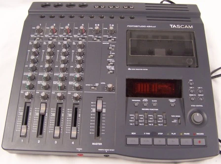

Take two PORTASTUDIOS, and call me in the morning!
