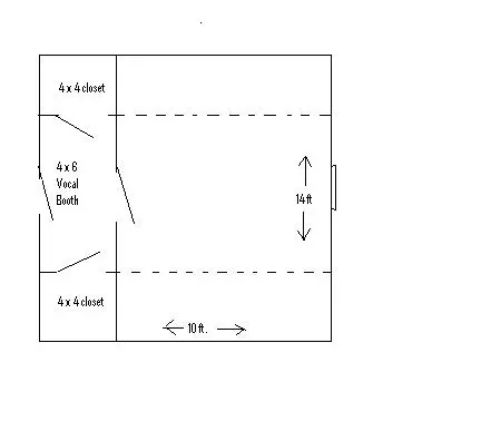

Hey, here's an idea for you (rough drawing, not to scale). Using your allocated 14x14 space, this plan would give you a 14x10 main studio room, a 4x6 vocal booth, and two small closets. You could consider porting some extra ventilation into one of the closets and use it for your computer(s) to keep the noise out of the studio. You would enter your main studio through the vocal booth - this plan would also help reduce sound transmission between your studio and hangout room, if that's important to you.

Thanks for the tips, esp. the one about avoiding squares -- good to know! I may be able to get a few more feet one way or the other to avoid this. I really like your idea of having the vocal room as the entrance. Clever use of space. Thanks again.

I disagree with the suggestion of divvying the space up though.
14 X 14 is pretty small, I'd try to keep it open and just acoustically
treat the whole space.
the other studio I've worked in is 28 X 26, w/ 6' X 6' vocal booth,
and it seems like there is not enough room for the booth sometimes.
