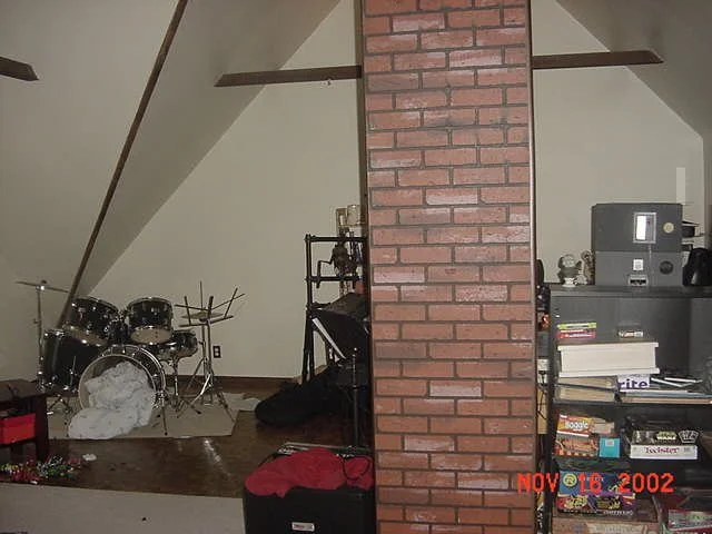

I mainly record myself (though I have had groups come up, and hope for more in the future). My setup is in the former attic of my house, which was finished in the 1970's. The house was built in 1888. The room itself is probably 18' x 25' on the floors, but there are a couple of built out and built in closets, so it's irregular. The room is approximately a prism in shape, except that the front has two gables. Lots of angles. The top of the ceiling - that is, the top of the roof - is probably 18' tall. The angle of the roof is quite steep - on the order of 45 degrees. There's also a chimney in the middle of the room that goes up to the roof. Other than that, the room is basically a loft-like space. The floor is linoleum over sheetrock. The walls are sheetrock or plaster. There is some carpeting on the floor. It's actually a great room to record in - but I'm finding it's hell to mix in.

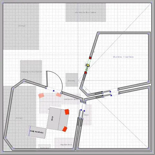

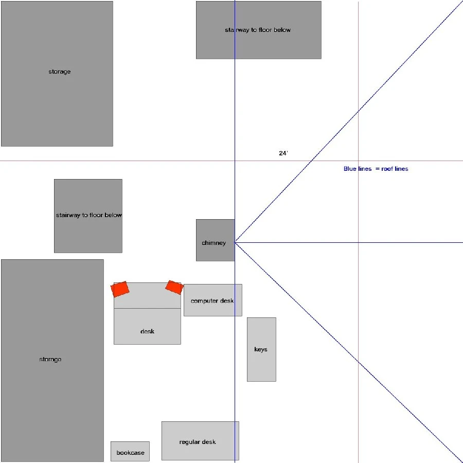

My setup is in a corner of this room, basically for neatness' sake. I recently got a pair of Mackie 824s. Based on what I've read (and the pieces of it I've understood), I think I have some severe bass problems in the corner of this room. The mixes I've worked on are not translating well to other systems.
So I'm trying to figure out what the best way to approach the problem is. I'm considering:
* leaving things where they are and trying to acoustically treat the corner to the best of my ability, or
* moving my setup within the room, which would involve perhaps some portable walls (the Auralex MaxWalls, perhaps) to keep the mess in check and to provide some acoustic treatment, plus add a few of Ethan's mini panels (which, by the way, look like a great bargain);
A couple of questions -
* I know that it's better to keep monitors away from walls - and right now, the backs are pointing into the room (the nearest wall is 15' away or so - where the monitors point is towards me, plus behind me there are bookcases, a desk, and assorted boxes, mix stands and whatever in the corner - the wall is probably a good 6' from the speakers) - and I know that corners are bass gathering places. Will simply moving more forward into the room make the bass problem better or worse, generally speaking?
* Since the room is so large, does it make sense for me to consider building either a temporary or semi-permanent 'room within a room' as a control room? Or does keeping the setup as a large room make more sense, given the size of the room?
* Because of the strange nature of this room - it's size, the angles, etc - would it make sense to hire an acoustician rather than trying a bass trap here, an auralex wall there, etc.? I am feeling pretty lost in trying to understand all this.
