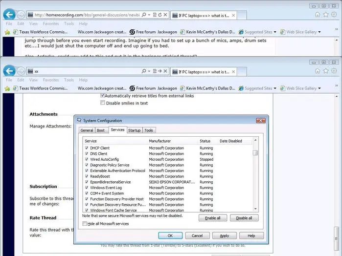

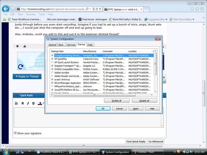

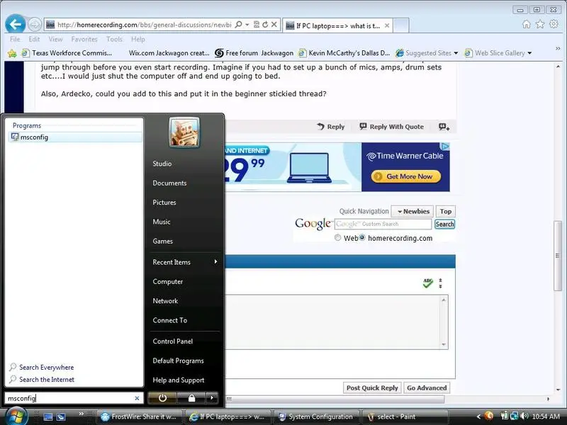

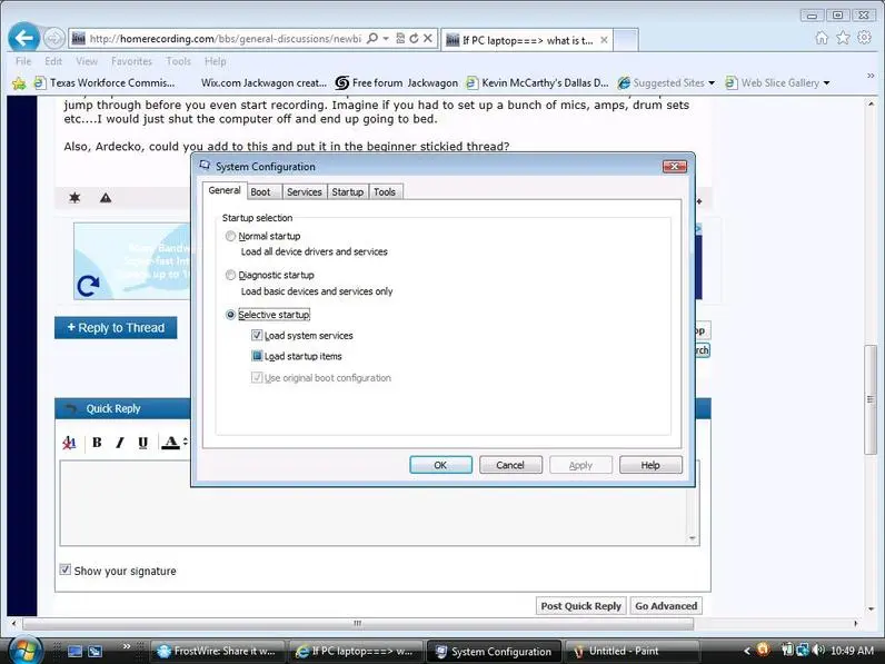

It's not all that difficult. After uninstalling the bloatware found on most comps, optimize your startup and services. Here's the quick process for that with some screen caps.
1. In the search bar, type MSCONFIG
2. Open MSCONFIG and select the STARTUP tab.
3. Deselect anything you don't want running in the startup menu.
4. Select the SERVICES tab. Disable anything you don't need. If you are not sure, then leave it running but if you disable something accidentally, it will start when a task requires it.
