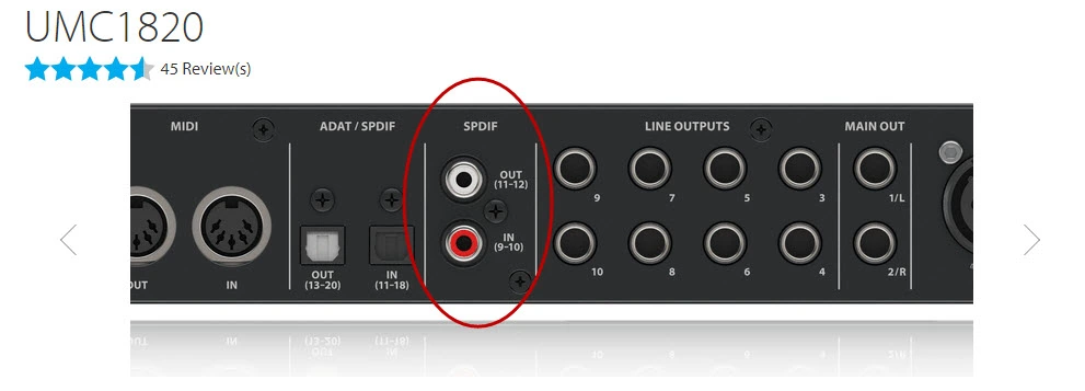

I have a UMC 1820 paired with the ADA 8200. I would like to run an external analog bus comrpressor The UMC has plenty of outs on the back - but the only way to get back in on the back is to use the SPDIF.
I tried buying an old SRC2496 - but I don't think that unit worked correctly. I don't really see any 'affordable' AD/DA converters that would work to really utilize the SPDIF connection on the back. So, I thought I would ask the question to see what others are using -
Whether you have a UMC 1820 or not, if your interface has 2 sends and 2 returns, but they are SPDIF (digital), and you use them - can you share how?
Thanks!!

Is the issue that you want the connections on the back rather than the front? I was going to suggest using the ADA8200 but then realised that its inputs are on the front. As you have found, there aren't many affordable AD/DA convertors around unless you go right to the bottom of the market or towards the top of the market. At the bottom there are lots of no-name A/D boxes like
and there are lots of D/A convertors to serve the hifi market like
Towards the top of the market you have something like the RME ADI2 or the Sonifex Red Box RBADDA range (which is what I use) but these are around £600. You can go up further than this to the RME ADI2Pro or units from the likes of Prism at over £1000.
One possibility in the middle of the market would be to use a Zoom U-44 which has a stand-alone AD/DA mode as well as its normal audio interface mode. The only issue is that its line output can't work at full professional levels so, if you have a device that expects peaks up to +24dBu, the Zoom won't drive it fully whereas the Sonifex will.
