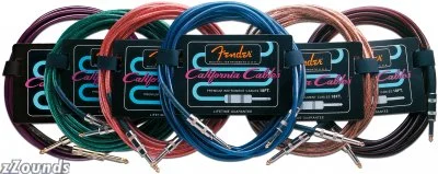

I just tried a 3rd cable, guitar cable..Lyon...on sale at Target 50% off..$3.
It was all treble and no lows.
It measured the exact same resistance as the "good one" at .2ohms both the g and tip.
I must have missed that day at Guitar class where they said cables make that big of a difference. wow?
My "good one" by the way, was a cheap, Fender California clear coated cable. $8

so i make a 10ft from this 20ft, instrument cable.
plug it in and its "muddy", go back to my Fender California and its louder and brighter...both the same length.
So at this point I'm thinking it must be the diameter or quantity of the wire strands.
The funny thing is my kid came in and I played them each cable.....
she liked the "muddy" one and said the other (Fender Cali) sounded "trebly"....
so I give up at this point.
Moral of the Test:
One mans sparkly-tone is another mans ear-bleed tone, and another mans "mud tone" is someone's preferred tone.:rolleyes:
