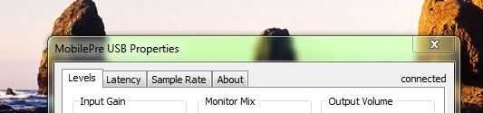

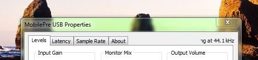

You gotta be careful with some of these M-Audio interfaces. I used to have the same problem with my Mobile Pre (Pro Tools saying its not connected). Open up the M-Audio control panel and check the status. When you have a program like Windows Media Player or Youtube open, it "disconnects" Here are some pics of what I mean:
You need it to say "connected" to open up Pro Tools
Make sure you have the latest drivers. Worst case scenario, I've had to physically disconnect and reconnect the usb cable, and on occasion restart the computer. I wish these cheaper M-audio interfaces weren't so finicky. This problem alone makes me want to go LE with an M-box of something.
