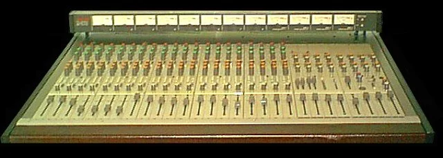

Find an M520,...
and don't look back. :eek: ;)
20 channels; 8 busses; 16 tape returns.
................ :eek: ;)
