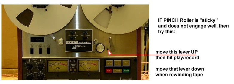

sticky pinch roller is pretty common problem for these machines. It can be fixed if you wish to...
If pinch roller does not engage when play/record - stop the machine immediately! :eek: Don't run it that way.
Mine is sticky from time to time, but I don't bother fixing it. I simply move edit lever up when play/record. If you don't want to hear winding, then move the lever down when rewinding/fastforward tape.
Try it.
See attached picture.
