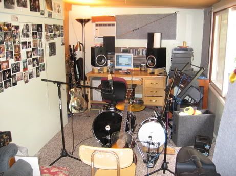

thanks guys. If I ever hit it big, I am flying you both out first class. Thanks for all your support. I wish I can meet you in the flesh someday. I love the mics, and the Electro Harmonix 12AY7 mic preamps. They have taken it to a higher level. The sound on these songs reminded me of stuff that I have by Rev Gary Davis. It was high quality, but not in your face. I guess they must of have used a similar set up. I like it to sound live, like you were sitting in the room listening to it all acoustically. My studio is sort of 1/2 dead and 1/2 alive. Here is a picture of it. It is a a 10'x20' wood room, attached to our detached, 2 car garage, built all of redwood(the local wood around here at the time). Thanks again for being so kind and supportive. Walter
https://i6.photobucket.com/albums/y237/waltertore/IMG_0122_1_1.jpg
