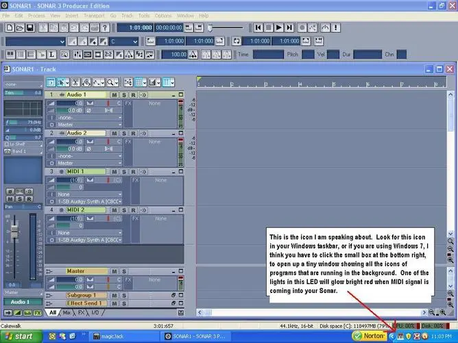

I'm attaching a screenshot of my desktop when SONAR is open. Look for the LED icon in your own system.

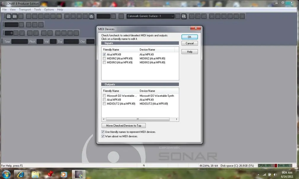

In the top it says Cakewalk Generic Serface-1
In midi devices i have checked for the IN Akai mpk49 and the OUT checked Akai mpk49
there are other choices for the out put, Microsoft GS Wavetable Synth, and midi out 2 akai mpk49.

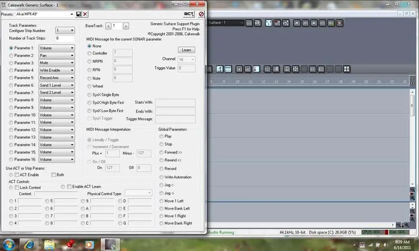

in sonar when i click on controller/surface properties, a menu pops up with a menu for the options, i wish i knew how to do a screen capture so i could upload it, any way i have the act learn function on.

Your Akai is showing up for MIDI devices. So that is a good sign. But you say when you click on the Akai the red LEDs do not light up. It should light up, regardless of having the Dimension synth setup properly on another track with the VST thing going on.
Before you will hear sounds, we have to get the MIDI signal from your Akai to be going in and recognized by Sonar. That is the first item on the agenda, presently. I'm not sure why it isn't working at this point.

Let's see if this works, the 1st image is what it is, i have tried every combination.
The 2nd, I have no idea what to put in here???
