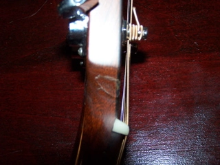

#3- I have found, at least on a Martin D1 that I have, that I used to hang them on holes on the wall, and the joint between the headstock and the neck appears damaged by the finish- like the lacquer has 'melted' in a few places. Is it possible that is the result, and can it be fixed? (picture attached)

Hard to tell without seeing it. I MAY have been as a result, but a good quality hanger shouldn't be a problem. As far as fixing it, that is pretty tough to do well. Yes, the finish can be blended back in (there are chemicals which will blend nitro back into itself very well), but with a satin finish it is very difficult to match the sheen to the surrounding finish.
