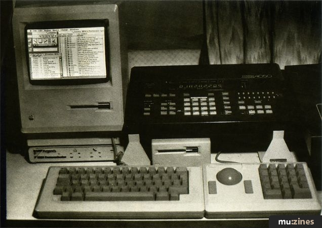

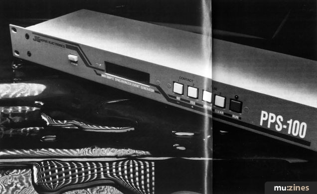

There were a few sync devices around back in the day. I used a Fostex 4050 with an Alesis HR16 drum machine and possibly an MMT8 sequencer (though I didn't use the sequencer for long before moving to computer). I also had a JL Cooper PPS100 but it wasn't as reliable at reading code as the Fostex. I seem to remember Tascam made similar devices too.
If you don't mind using proprietary time code there were a few cheaper devices around too. I'd suggest digging around the Muzines website for reviews in magazines like Home and Studio Recording or Sound On Sound.

It depends on the gear you have? What can the sequencer read and write? MIDI, SMPTE, proprietary? Then what your 4 track can support - You will probably end up with a piece of hardware sitting between the two JL Cooper units were popular back when this quaint way off working was common.

Glad you found an inexpensive solution. I was going to chime in with how unreliable the J.L. Cooper units were - frequently freezing, accompanied by a gawdawful, loud zippering sound.
