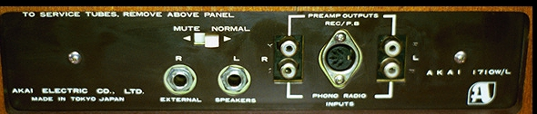

The 5-pin connector is a DIN connector used for connecting the preamp REC/PB output to some other component.
NO...there is no 48V phantom power.

btw this is the input on the back, i think it actually says "rec": http://www.angelfire.com/electronic2/vintagetx/AK63.jpg

First thing is to simply treat it like any other stereo recorder/playback device. The 5 pin connector is an old high connector that has left and right record and playback on one connector. Very common back then and stolen to be used later for MIDI connections. The phono connectors are the ones to use, because the DIN spec levels are different, and not quite what we have now. The phono connectors are still the current standard. It will sound ok, ish by current standards but isn't a shining example of the time. It's just not special, will cost you to run it if you need to buy tapes, and probably be unreliable as the rubber drive belts are likely to be shot.

The DIN connector. Japan and the Americans did not really "get" DIN and made a dog's chuckup of the system. Imported (to here) DIN gear was needlessly noisy and had high output Zs leading to HF loss*.
Unfortunately the RCA connectors were often just a resistor network that mimicked the wrong DIN implementation and so made noise even worse! As with much to do with tape you need some mechanical and electronics smarts to get and keep decent performance. If you don't have them or can afford them as do? Best leave it and explore "sim" software.
