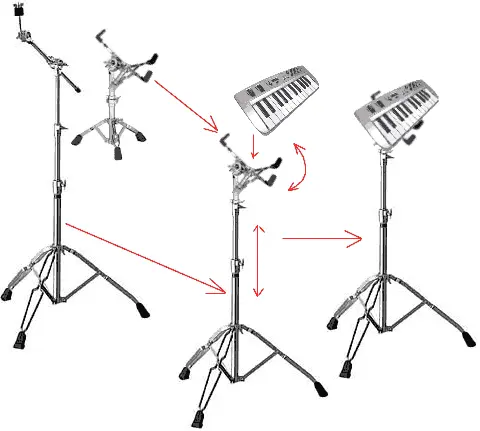

here's an idea-thought
You can try this :)...pic is attached...using powers of digital-imaging :)
You can take base-part of cymbal stand and top/holder part of snare stand (which I think may well grab'n'hold your controller, but there's no way I can know for sure...but I think you can figure something out to make the controller seat nicely and tight in three-arm snare-grabber ;).... So this way you can adjust height and angle of your controller and it all looks nice'n'cool and 'drum-set friendly' :D

Thanks all for your comments and especially to Dr Zee for the enthusiastic diagram. I don't have any snare stands that fold up small enough to hold the keyboard well enough for live performance. I thought of that idea, and that's probably what it will be in the end, but perhaps I'll put a clamp on the hi-hat stand and forgo an extra set of legs.

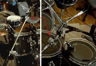

Here, man.... what the heck... it took me like 5mins to set-it-up with my ol'fatar controller :) ...I'm attaching quick shots-pic (due to file size limit I can only post small images...but you get the idea... the controller placed right above the hi-hats... still can be moved up above hats few inches).
I'm using here Pearl snare stand's holder and Pearl cymbal stand base. Parts match perfectly. But if you use different barand/design parts, then they may not fit... well, dooh ;)... What is the size of oxygen 8? Fatar is 10.5" .... snare holder grabs it perfectly. It looks like the smallest width it can hold tightly is about 8.5".... if your controller is smaller... I'd say you can simply add-up something, like piece of wood/plastic/felt or what have you...
well, what ever you do - good luck with this craze' set ...good luck playing as well - heh heh :D

while playing around with this ;)...here's another thought. You actually can attach the snare holder part to cymbal boom, and then you can place your controller anywhere around/above your drum kit the way you'd place a cymbal. Now of course, your controller can't be too heavy, plus it's a bit shaky...especially if you are planing on some 'heavy key-playing' :D . Light cymbal stand may not work well for such application. I did try it with one of my heavy tama stands with counterweight on the boom... and it feels kind of OK. I'll attach photo here.
/later
