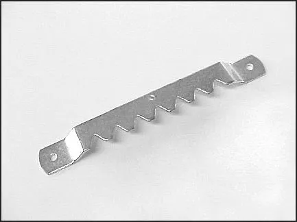

Is there a panel on the back of these "frames"? If so, use a "hook cleat" for the wall units. If not, probably use "picture frame" wire, although I think that is a terrible way to hang these types of frames. This is one of those "not thinking ahead" type projects I see all the time here. Post fabrication solutions usually are bunk. Had you thought ahead, you could have "built in" the solution. If there is NO panel, then your solutions are limited to hardware store "after the fact" crap hardware, that at best is usually a pain in the ass, and or unsightly. :rolleyes:
Anyway, if the back of these units is "open", or exposed fabric, the frame rear edge is the only place to fasten hardware
. Maybe two of these per frame would be your best bet. At least on the walls.
fitZ

Would they work for ceilings and corners though FitZ? That's why i went for the glass plates, coz they do them all
