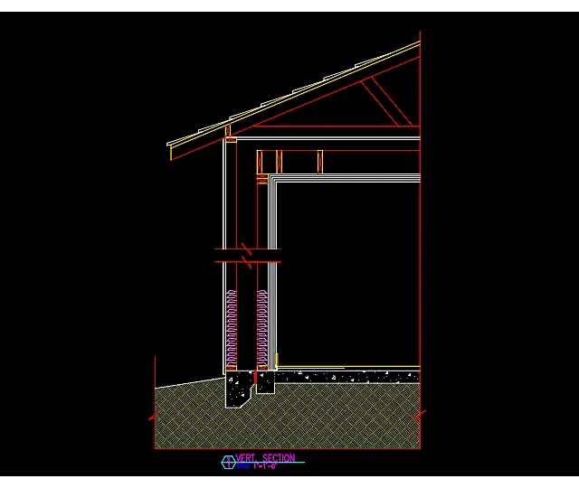

Hello guys, I just posted a drawing and question regarding this "conundrum" on the studiotips site. As there are ongoing discussions relating to the transmission loss of isolated slabs as a function of interior leaf MASS/matching, I am curious myself, how the exterior leaf/ SECOND LEAF(between roof and interior leaf) must address this MASS/TL at the slab, and how to support this MASS of the second leaf. Fundamentally, engineering the trusses is NOT the question. It is this MATCHING the exterior wall mass to any TL of the slab that is the question Here is a TYPICAL drawing that I posted to illustrate where I am referring to. Also, the HVAC comes into play here also, as penetrations by ducting etc must be addressed also, if HIGH SPL isolation is to be accomplished. No? :confused:
Anyway, maybe we will get some PRO answers to this soon.

Thanks MS. Like I said, it is NOT the real deal, just an illustration for the questions I asked. Personally, I think there is a lot of questions to be answered
before truely designing a studio from the ground up. But this has to do with all the data such as neighbor distance, music db profile, available budget etc etc. I'm certainly not suggeting this drawing as an "actual" build. Which in reality is most typical of residential "after the fact" homestudio builds. If it were me, and I had the budget, I would build a concrete tiltup, or concrete filled block walls and lift lightweight concrete ceiling slabs(or poured) and build a roof over that suppored by the wall perimeter. But how much money do you have? :D As well as need?
Anyway, as usual, I'm just poking my nose into this stuff to bring out the questions that have'nt really been addressed before just for the sake of learning myself. Hadn't it been for Paul Woodlocks thread(studiotips site) in regards to transmission loss of floating concrete floors, many questions regarding floating wood floors would NOT have come to light, at least for DIY's. Lots of threads have appeared in the last 5 years here suggesting floating a room on lightweight wood structures, and walls which did NOT match in TL, which left floors performance actually amplifying certain frequencys to the outside world, while allowing resonace to remain higher than the walls/ceiling. It is in that light that I ask these type of questions NOW, as "net fact" solutions could waste peoples time and money shoud they actually use them. Or so it seems. I've been guilty of this myself and am only now become leary of suggesting things as this thread illustrates :rolleyes: Anyway, thats why I pursue these threads.
