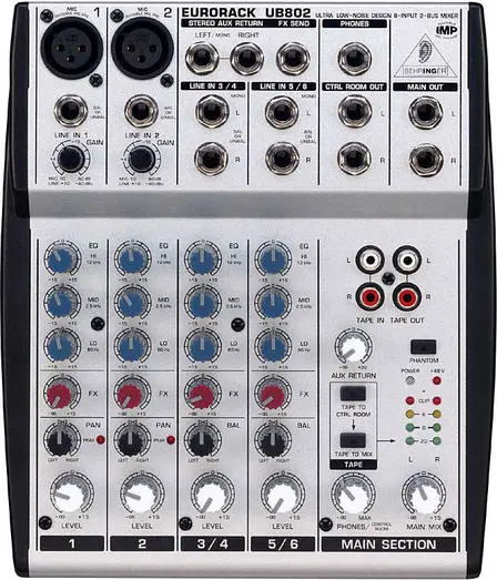

I have a behringer mixer and i was just wondering if neone knew how to hook up the headphones to where when u talk through the mic you hear yourself in the headphones.

Post a picture of ther mixer and I will tell you which button to press.
You're gonna need 1/4" studio headphones, and plug them into the "monitor" or "phones" one.
here is da pic

here is da pic
1) Plug your headphones into the 'phones' port
2) plug mic into channel 1
3) Turn all the knobs on that channel to 12 o'clock except for the red one
4) Turn the phones and the master volume knobs to 12 o'clock
5) *Optional* - if you have a condenser microphone press the phantom button
6) Listen to your voice
