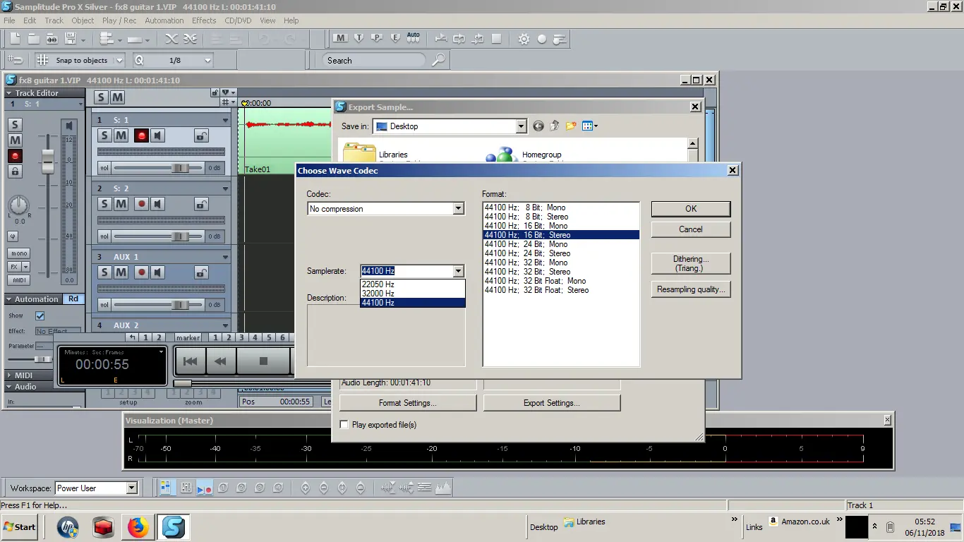

Samplitude does this very nicely.
See attached, first the .wav is converted to 16 bits at 22050 Hz. I would save that to Dtop then plug it back into Sam to do the MP3 smash.
Unfortunately the free Silver version seems to be stopped (but if you can find a download MAGIX will still activate it) but you could download a months demo of Pro X. Magix Music Studio probably has the same converter in it.
Reaper will almost certainly do it but, compared to Sam, I found the process much more "clunky".

Even Samplitude does not do a "one shot" 24 bit, 44.1kHz .wav to the 16bit 2050Hz MP3 form AFAICT hence my stepwise procedure.

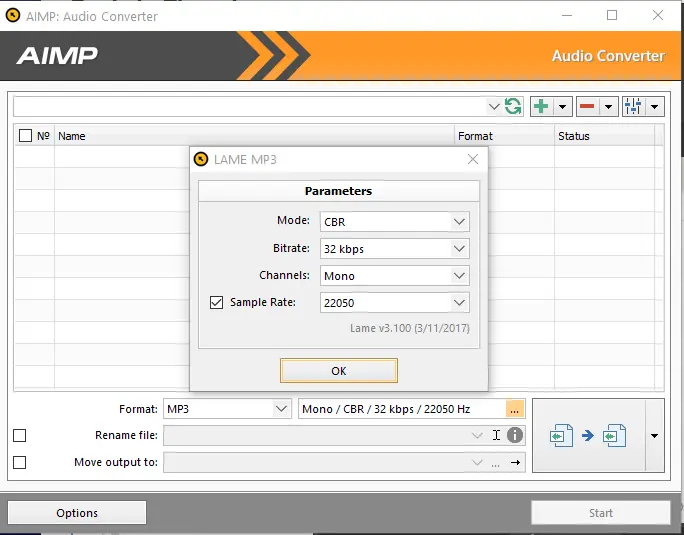

I discovered that I can do what I need with my free AIMP audio converter.
The quality comes out pretty good for these parameters, and the uploader of the website accepts it. :)
