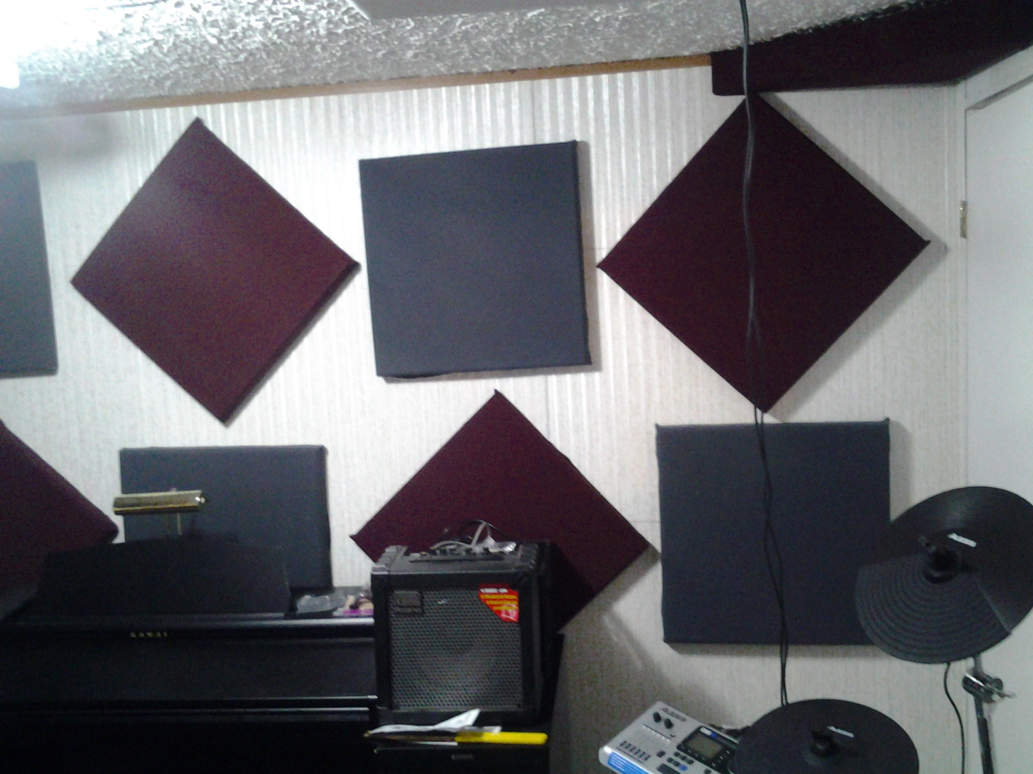

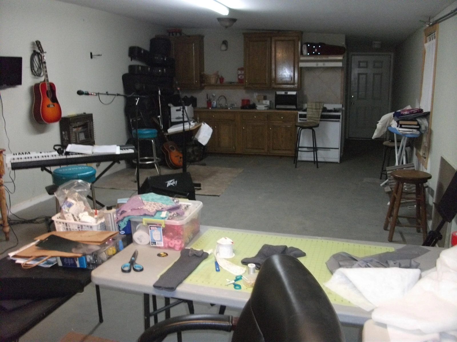

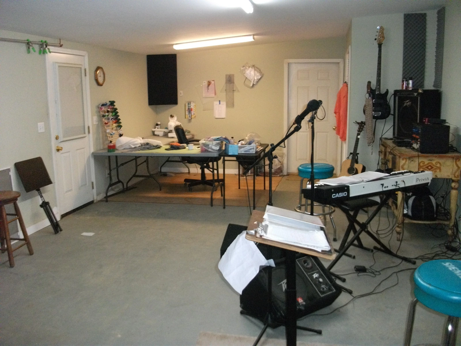

I have finally completed my studio!! I want to thank mjbphotos and all others who have posted. I tried to take everyone's advice and utilize it for my situation. I am posting some pics of the completed project to show others what can be done with a small space. While it is not perfect and must be shared with someone who sews and embroiders this is what I have and must make the best of it. I ended up with several more dollars invested than I had planned, but we did all of the work ourselves: Painting, build and cover panels, build the desk, changed lighting, etc.. and it feels really good to see, and hear, the difference. The panels really made a huge difference. Thanks again for everyone's help. Completed pics are attached.
