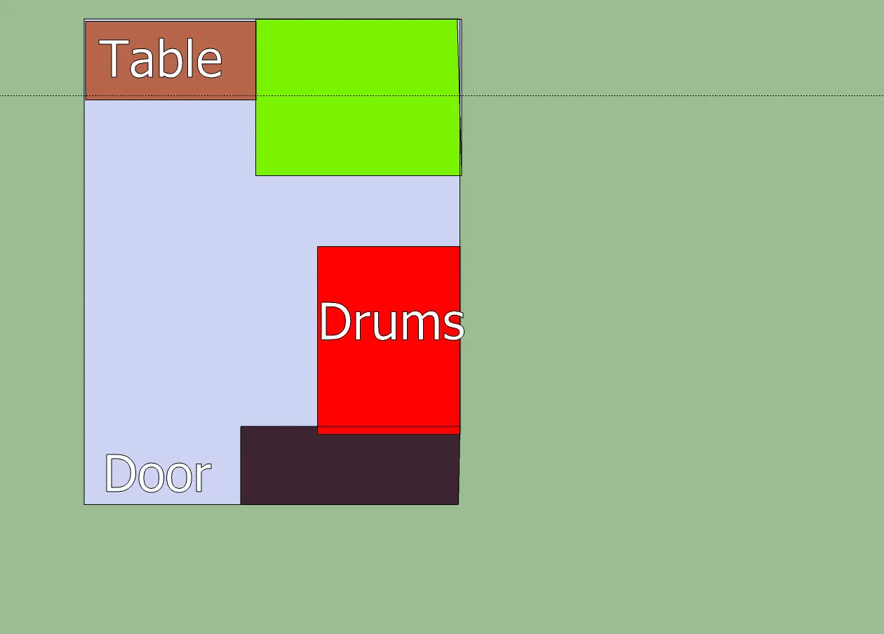

Thanks for the reply! I have DI'd in the past with fairly good results and i have Amplitube 3 which seems pretty good to me just for this song I thought a real amp would be better. Its hard rock, fast tempo kind of song. My room is infact a bedroom turned recording space. The room is around 3.10m x 2.40m.
Thanks for the reply! I have DI'd in the past with fairly good results and i have Amplitube 3 which seems pretty good to me just for this song I thought a real amp would be better. Its hard rock, fast tempo kind of song. My room is infact a bedroom turned recording space. The room is around 3.10m x 2.40m. The green thing in the Pic is a couch :D
oh and there Electric drums! I record with MIDI for those

I'd set up by the door with the amp firing down the length of the room towards your couch.
The couch should absorb some reflections from getting back into the mic.
Stick a couple of foam panels in front and on top of the table, just to tame reflections.
I'd go with the 57 up on the grill like was said by MJB and just tweak to taste.
